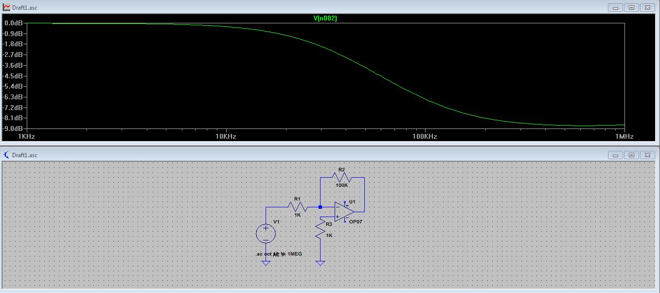

                      LTSpice simulation Problem
                      This is am example of the issue I having with LTSpice. I built a simple "gain of 100" opamp circuit, but my results are obviously very wrong. I have spent a long time on it and I cannot see the error!
                        You might want to try providing proper supply voltages to the opamp voltage pins.

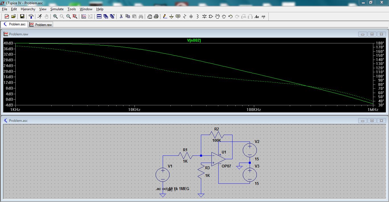

                          Oh! Thanks!!
                          It works, but that is a bit kludgy (at least the way I did it [attached]). Is there an easier way??
                            Easier... not really... but less clutter by using Tags (Labels).
