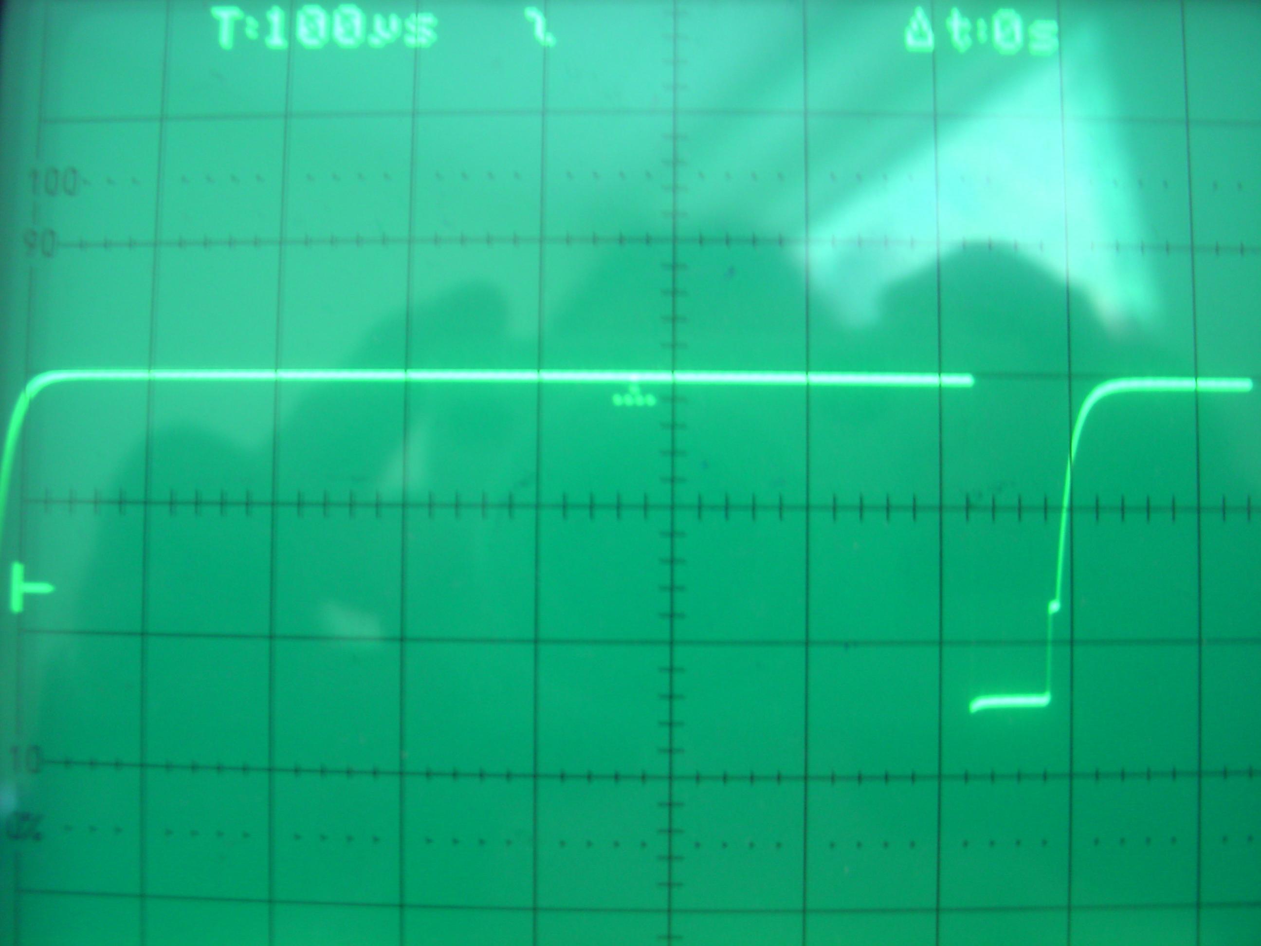

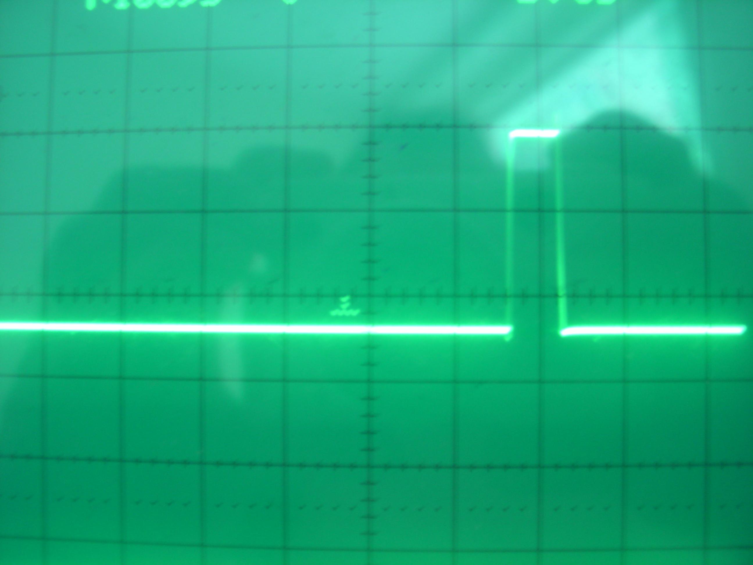

i just powered my hammerhead for the first time tested and ive run into problem with the coil drive...when i connect the coil i cannot control the tx pulse current and the circuit is then drawing 1.5 amps and mosfet starts to smoke...i scoped the output of the 555 timer ic and adjusted the tx pulse and it is adjustable but will not decrease mosfet gate drive !!!!
