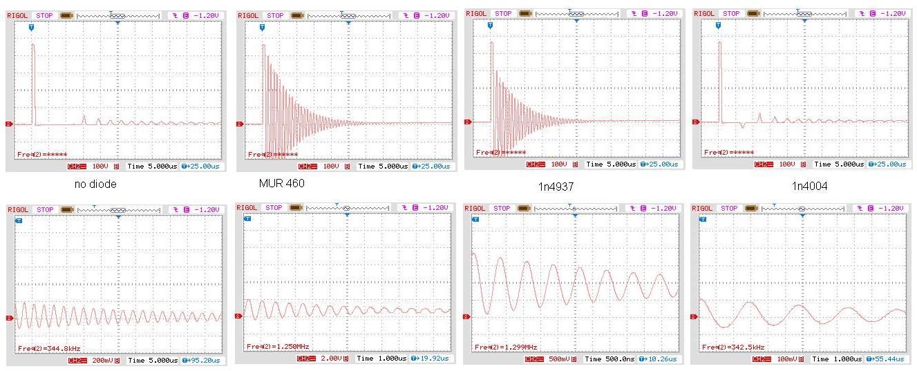

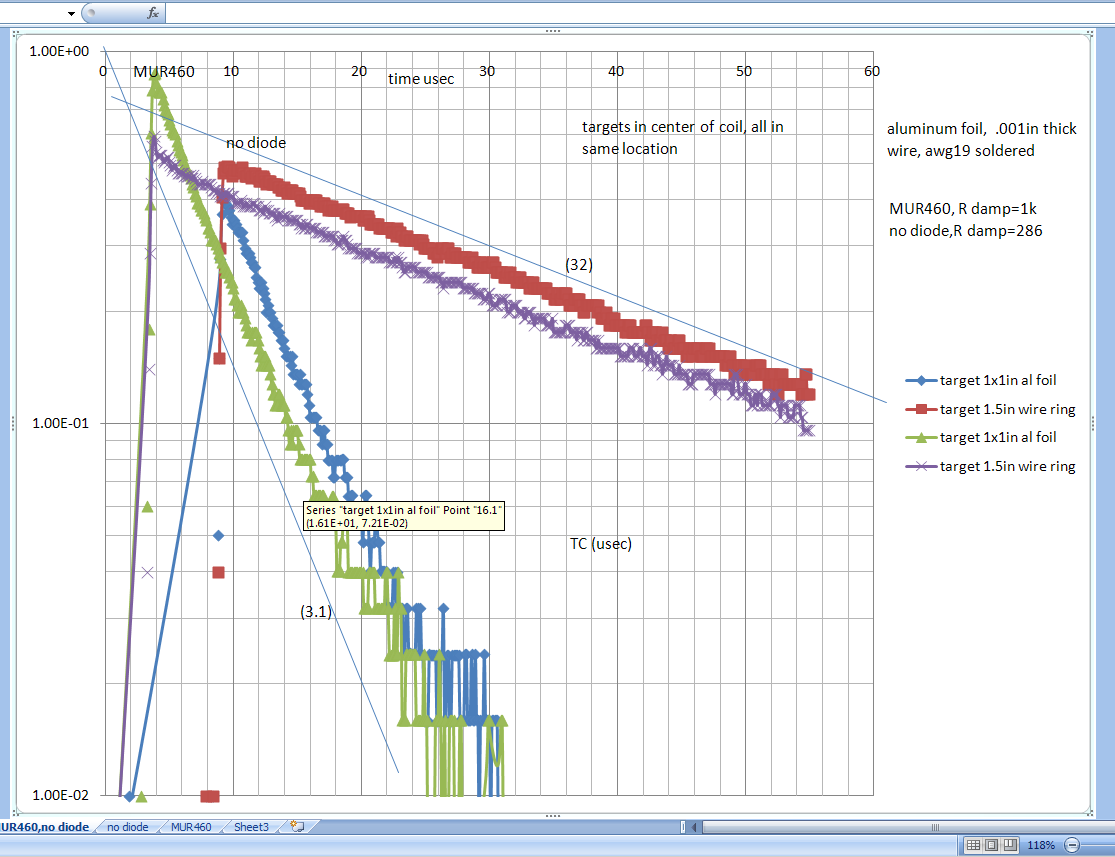

    A chart and some scope shots of my bench circuit I posted on another thread awhile back. The (MUR460, no diode) is a time constant plot of two targets with the diode and with the diode shorted. The diode would allow sampling at 4usec instead of 9.5 usec. The amplitude is higher with no diode do to more voltage charging the coil causing a higher peak current. The on time could be increased to increase the peak current for the diode circuit. Don't see any advantage or disadvantage with the diode circuit if sampling with longer sampling delays for higher time constant targets. The (diode no diode) scope traces are coil volts with R damping disconnected for some diodes I had. The lower scope traces of resonance are with the scope probe disconnected from the coil laying near the drive circuit.
          How do you collect that data in the first chart? What does the setup look like? It appears that you automated a translation table to operate with a DAQ.

                    I record the amplifier out with a DSO, the one in the scope pictures. One recording with no target and one recording with target. Subtract no target recording from target recording with Excel and chart data. The external trigger sets time zero when fet gate goes low.

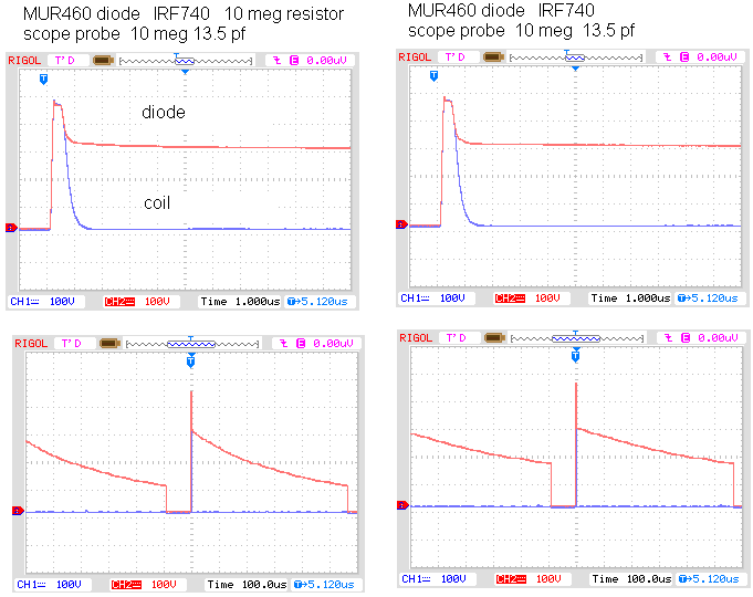

                          Recorded scope trace of decay with and without 10 meg resistor. 10 meg to ground without the resistor and scope probe, 5 meg to ground with the resistor and scope probe. Plus the added capacitance of the scope probe. Wondering if comparing coil resonance with circuit resonance (R damping disconnected) or recording voltage drop is a good way to compare diodes.

                            The only reason that I compare voltage drop is that is an indication of dynamic forward resistance, thus the effect of the diode on peak coil current. It is just a personal preference that I have... just as I prefer using insulated drain mosfets.
                            Maybe we are talking about different voltage drops... my reference to voltage drop us forward voltage drop at a particular current, as stated in diode specifications.

                              One more experiment to test diode effectiveness. Scope probe near circuit not connected to minimize circuit change. R damping disconnected. Circuit resonance: (coil connected to drain, 345khz) (coil connected to MUR460 anode, doide in series with drain, 1.23Mhz) (coil connected to 300 ohm resistor in series with 1N4148 in series with drain, 1.28Mhz). Would think the 1N4148 and 300 ohm resistor would give very good isolation. Without a frequency display I couldn't tell the difference with the MUR460. The MUR460 does a good job of isolating the drain from the coil.
