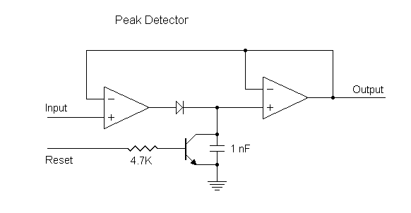

            Re: Peak detection
            Jan
            This is the basic peak detector circuit.
            The first opamp provides a high impedance input so you don't load down your signal source, and a low impedance path to charge the capacitor.
            The diode is what detects the positive peaks.
            The capacitor is the memory.
            The transistor is to reset (clear) the memory. After you read the output with the ADC, pull the resistor high with a logic signal for a microsecond or so. That should be long enough to discharge the capacitor.
            The second opamp provides a high impedance load on the capacitor so it does not droop too fast, and provides a low impedance output.
            Robert

                Re: Peak detection
                A few points about this circuit.
                The diode should be a low-leakage type, e.g. 1N458A. There are ways of compensating for a higher leakage diode, but the circuit is more complex.
                The first opamp must be able to drive a capacitive load, have a high differential input voltage rating and a decent slew rate. The NE5534 is quite good here.
                The second amp should be a JFET or similar FET-input amp.
                The capacitor (in common with all sample/hold circuits) should be low-leakage and low-dielectric absorbtion, e.g. polystyrene etc. A small resistor in series with the capactor to give a time constant of about 1uS (in your case) would also help. e.g. 10nF & 100R.
                You should include a feedback resistor in the inverting input path of opamp 1. This protects the input of opamp 1 against discharge currents from the capacitor when power is switched off. You should also put an equal-valued resistor in series with the non-inverting input to maintain unity gain for opamp 1. e.g. 10K.
                You may also need a small (c. 30pF) capacitor between opamp 1 output and inverting input to adjust the settling time.
                For your application, you might also consider a high-value bleed resistor across the capacitor.
                HTH,
                Nicko
                  Re: Peak detection
                  Nicko
                  I admit that 1 nF may be cutting it a bit too close for a bipolar opamp. I wanted it small so it would be easier to charge, but maybe a little bigger would be better.
                  It seems to me that some of your suggestions are overkill for a circuit that has a 5 usec wide pulse and only needs 10% accuracy over 1 msec.
                  I was thinking of an LM124. I did not say that because I did not know if they still sell them. But I figured there must be something available today that is cheap and has a bias current less than 100 nA. I do not see that high speed is necessary. I would think that 1 MHz and 1V/usec would be fast enough.
                  Robert
                    Re: Peak detection
                    Hi Robert,
                    Yup - my comments were a bit of the purist type - with the changes I suggested you could get to less than 1% settling in 1uS. With an 8-bit ADC, Jan is looking at better than 1% resolution anyway, so going for sub-1% (actually about 0.1%) settling in 1uS didn't seem that far off.
                    If the pulse is 5uS long, you still have to detect possible changes during that interval - its not clear from the original post if the pulse is a square wave or a sample that many vary. So my comments were geared towards that - i.e. something that will detect changes intra-pulse, not just inter-pulse and will settle easily within the pulse width.
                    The components suggested are not very expensive - the 5534 will drive the cap nicely from 0-2V in the interval, and a TL081 or similar JFET is also cheap.
                    As the hold time is short - 1mS, you may indeed get away with a bipolar second amp and a small signal diode like a 1N914, however a JFET is not pricey and will definitely work.
