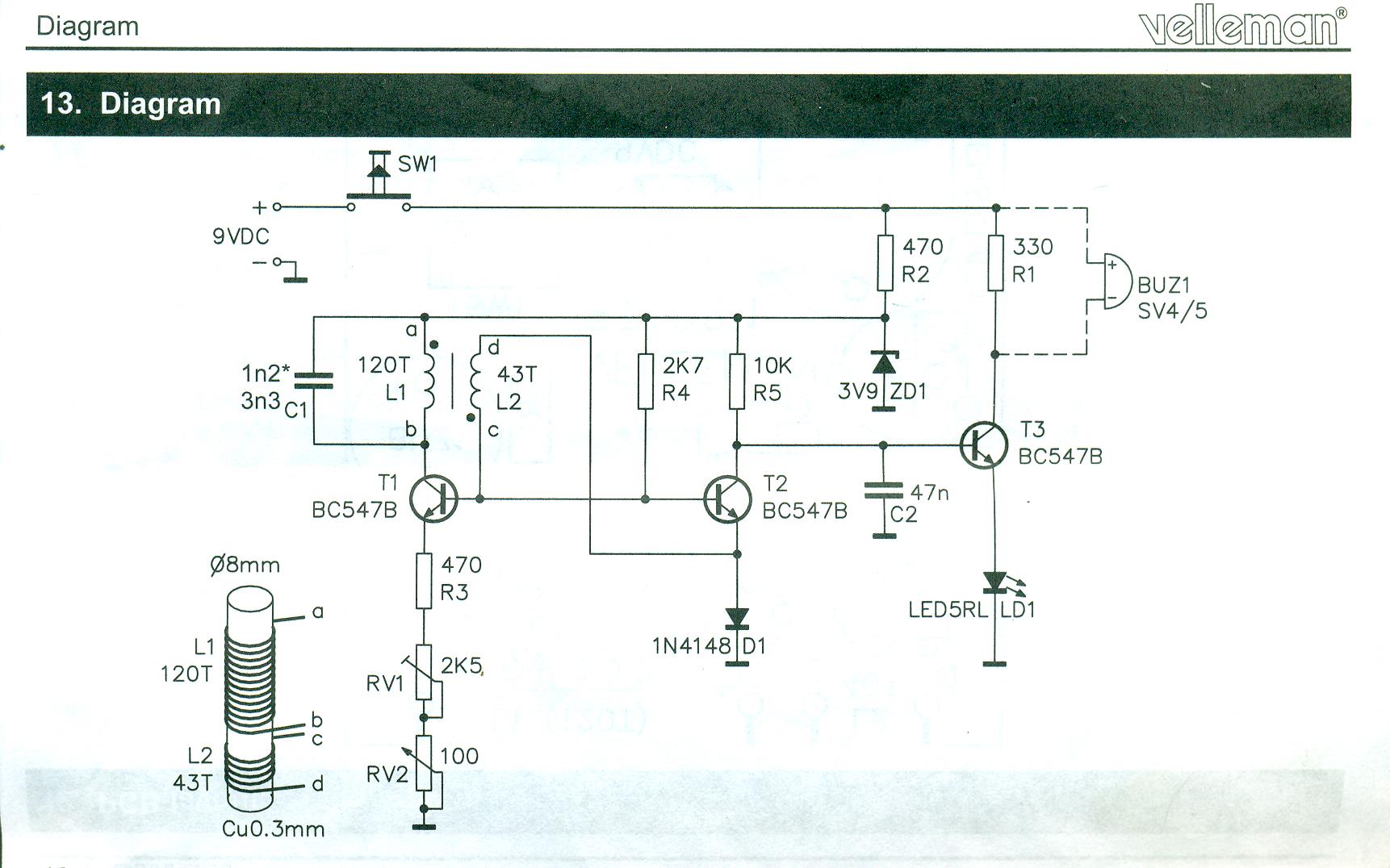

My questions on PP Frequency are as follows:
#1..What circuit components are used to create the frequency of a PP ?
#2.. How do you test to see if the frequency is correct; is an oscilloscope required or can frequency be checked by a less-expensive method ???
Thanks in advance for your help on these questions.
