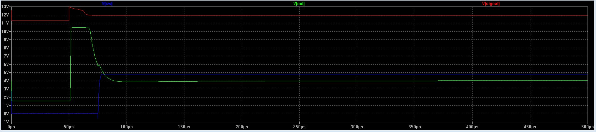

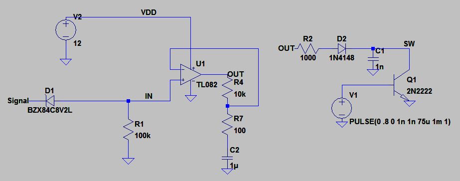

    I'm looking to sample the amplified signal first at the 'knee' and later at a time that will allow me to determine a steady state value.
    I've read that subtracting 2 such samples helps eliminate ground effects / balance the signal.
    To understand this better, I've tried a simulation (attached) where a non-inverting amplifier is biased using a zener diode (maybe noisy but I dont really care at this stage) and a simple BJT switch stage is used to sample and hold the voltage at the knee. The circuit would be microcontroller driven so that both the sampled knee voltage and the steady state voltage would be acquired by ADC.
    From the graph, VOUT and VSW would be ADCd by the microcontroller.
    My questions are:
    1. At what point is it best to sample to eliminate ground effects?
    2. Would simply accumulating + averaging the samples (after subtracting them) be sufficient to make a sensitive detector?

              Beenthere, your sim response looks slow. The raw flyback (red) is about 20us wide, should be closer to 5us which will end up settled at the preamp output in 10-15us.
              Ground has a 1/t response, most metals have an exponential response, at least as far as we're concerned. A typical subtractive system would have a target sample at a delay of 15us with a width of 10us and a ground sample delay at, say, 30us with either a variable width or a separate variable gain path or a mixture of both. Depending on the strength of the ground and the tau of the metal, either one can be dominant at later delays, so the output of a subtractive GB circuit can be either positive or negative, depending on the GB setting and the tau of the target.
              Yes, accumulating & averaging the samples increases SNR. That's what pretty much everyone does.
                Thanks Carl, yes, the signal was quickly generated by a large (700 uH) coil model I happened to have on file - not ideal, but I understand the basics now.
                I had been toying with the idea of compressed amplification so will take Davor's suggestion and look into a log amplifier too. I have to build some circuits and play for a while. Fortunately, the control side of all this will be trivial using a pic.
