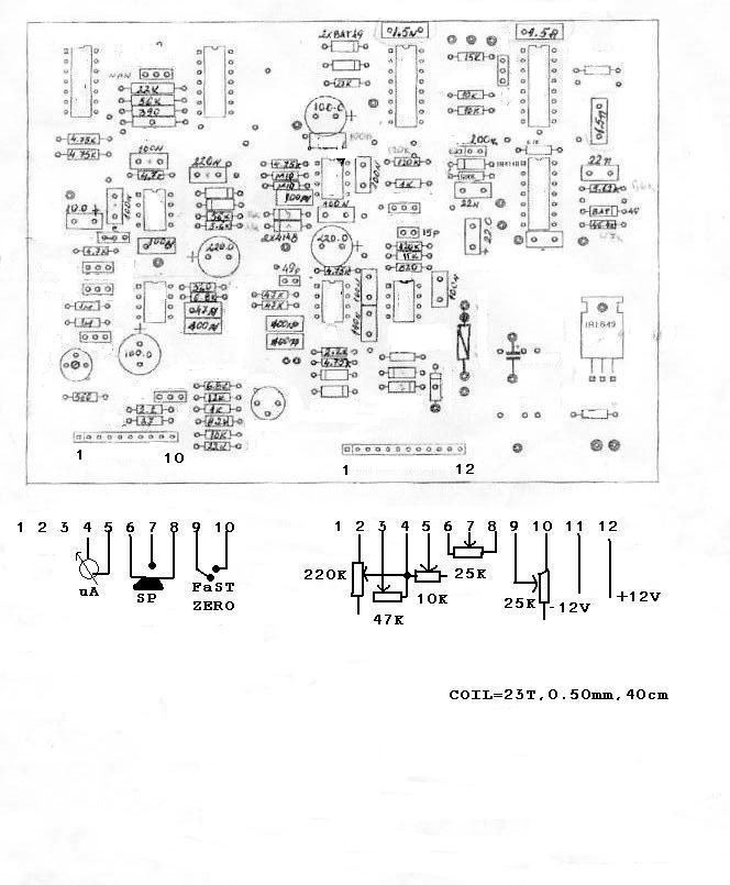

    I've just received a Sniffer XR-71 PCB I ordered from eBay and which came from Bulgaria - it's supposed to be a reproduction of a Delta Pulse PI detector.
    I wasn't sure exactly what I was getting - the listing said just a PCB, while the photo showed a board populated with all its components. Turns out it's the whole thing which only needs boxing up, controls adding and a coil which can range from a round 28 cm to 1 metre square and probably beyond.
    Very nice-looking board and very well made, said to be tested ready for installation.
    No instructions came with the PCB so I'm looking for some instructions for the controls and coil. There are three headers on the board which the pots, battery and coil will presumably be wired to but none of them is labelled and although I passed the practical tests I failed the mind-reading . . .

    Has anybody built this machine in any form - PCB or kit - and can they please supply details of the power and control connections and coil details?

    Any pictures or a link to the ebay ad? We might be able to figure out the wiring...
    Hmm I found this; http://powerscan.eu/cart/index.php?r...&product_id=60
    But no info on that site.
    The attached appears to be your layout but the schematic that came with it doesn't show the pinout of the connector.
    I found a bit better one see attached;

      That's the one all right - not much to help on the pics!
      But all should be OK as the site owner has just replied with two .doc attachments - I was obviously just being impatient! Can't open them yet as I've just built a new computer and haven't yet installed any word processing software.

          Wow. I've just installed LibreOffice and opened the documents I was sent. One is a connection diagram with values for pots and dimensions/turns for coils and the other is an operating manual.
          Very happy at the moment - will have to get it all built up and report back when it's done. It'll take a while as I need to order the pots and stuff in - luckily I already have a 12V 2.1A sealed lead-acid battery which is alleged to give 20-25 hours operating time.
            That's great, thanks! It looks to be the same as the one in the connections document - as it should be!
