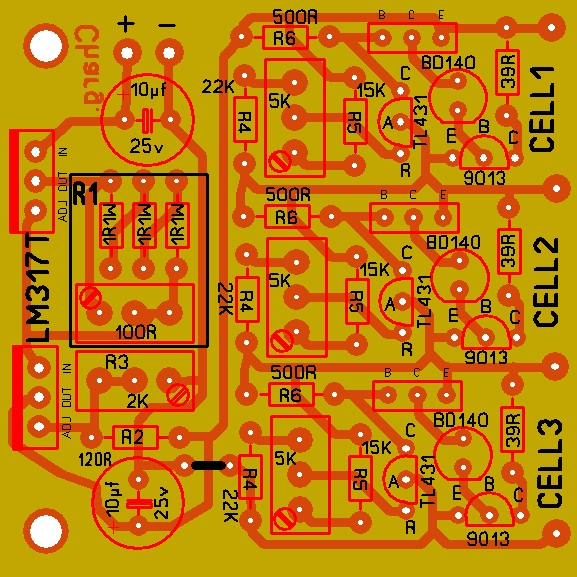

        Hi Daren. I took several of those cells from an old laptop battery pack, and I'm planning to build this charger.
        http://coolcircuit.com/project/lipo_...o_charger.html
        https://translate.google.com.ar/tran...html&sandbox=1
        This is my PCB:
          Thanks, that is a nice PCB.
          I think I give a try to this one:

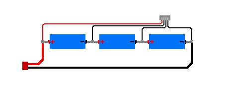

              The only problem is that I have to disassemble the enclosure every time I need to take out the batteries for charging. I'm looking for a solution that will allow me to plug some power supply to the controller box and charge the batteries without taking them out.
              If we assume the not from you written information is correct you have already a charger and you are using li-ion or lipo accus.
              So wire them "balance chargable" with 4 connectors as show on the above picture
              http://www.geotech1.com/forums/attac...6&d=1414070887
              or wire them with just plus and minus if the charger also offers just the 3 in series option and plus and minus only.
              You can use an additional coil jack and plug for this, too.
              Or you built into the housing a seperate charging-circuit inkl. the needed power source plug for it at the housing.
