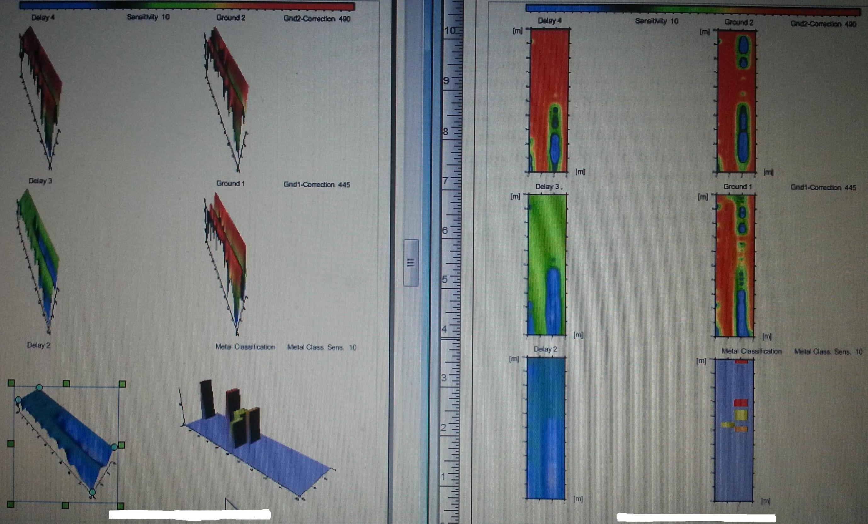

      Now concerning my question about deepmax Z1 or Geo examiner is because I had the chance to use Deepmax (used coil covers 4m deep) at 1 of my properties which I have a reasonable doubt it might include something, it gave me real interesting results, I didn’t jump to start excavations or anything (because as I said before, I think such technology doesn’t exists yet) but still I didn’t let it go, that’s why I tried the forum to check if any 1 have a clue, as the manufacturer company doesn’t help explaining maps.
        The attachment shows the interesting result i had, the rectangular shapes (uniform engineering shapes doesn't look a natural thing).
        I'm not trying to advertise for a detector brand over here, simply the Detector and the software have some sensitivity/filtering mods that can affect the results, so i'm asking if any 1 heard about it (legit or not) or used it, to figure out if i used it (set the calibrations) properly.
        P.S: Sorry if the pic isn't clear enough, i just used my phone to take it.

                I had the chance of using deepmax Z1 because one of my friends bought it, and i did read the catalog and all the info i could find before using it, so i do have some clue about it (my testing result was attached, which is the 3D logger software), problem is mainly identifying the sensitivity/filtering needed which do affects the results , as the software itself doesn't have any catalog (not like the hardware).
                Yes the detector itself and also the software, both have some sensitivity and filtering mods, i did use the correct calibration and all other mods.

                  such 3D imagining programs can cause troubles.
                  But 1st: 10m depth you only will get with proton- or nuclear-magnetometers on ferro-magnetical stuff from sunken ships etc.
                  I don't know exactly the filter-settings that are possible but first for shure you need a good calibration so you have
                  a clear center-region without any signals.
                  Those pictures are nice but usually a simple 2D image is absolutly enough if it shows useful find-results.
                  One problem by using such stuff is that afterwards you still have to start to remove all kind of small finds first.
                  So often its much better to clean first with an usual MD the area and afterwards you check out the real depths.
                  For magnetometer-based detectors such an imagine-software is useful, but not really for P.I. detectors
                  which can't find cavity or other anomalies.
                  This is just an extremly overpriced P.I. which I would only use with the lightweight 50cm coil if the discrimination
                  and the depth is really super good, otherwise I would not use P.I. because P.I. discrimination and discovery speed
                  is much worse as with other detectors. But if you still have the possibility to test it, I would bury stuff really deep
                  for finding out by personal tests how good it really detects them with the 1m and 50cm coil and what exactly is
                  shown on the imagine pictures.
