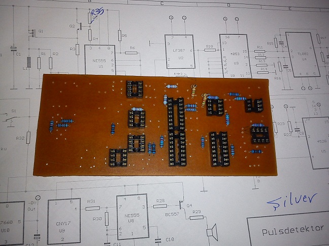

i am lookung for any modification on TINY MD...
are the pcb correct?! or have any error?
have you any new pcb file in LAY format?
what is the liy litz or yv?!! can you show me by photo?
Black resistors are bridge (zero ohm). In original "Bauteileliste" R3 is 1 k. Black L1 is a coil!Attached Files
