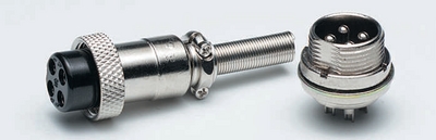

              Hi, for those of you who've built kits, do you know if I can use an 1/8" phone jack and socket as a 12v power lead coupler? At the moment I have a 9v style clip on n it's a bit if a pain clipping on and off? I have a spare jack and socket, if it's a no go and will have to buy a DC connector. Thanks for any input

                  should be ok its only a few mA
                      Hi Al 2014; phone plugs and jacks are prone to shorting as you slide the plug in and out. The leads tend to break or short unless large size wires are used. I use a 9v holder that works quite well. The battery snaps in and out with ease. There are a number of styles on eBay.
                      http://www.ebay.com/itm/New-9V-Batte...item5af32da693
                      I just reread and realized that you need a 12v connector so the 9v holder won't work.
                        bad for use like a ps connector. I did see the sound jack used, but that was 6mm. I did see it in Deepers 10DD. better use 'microphone connector'
                        them are much at ebay for good price.Click image for larger version
