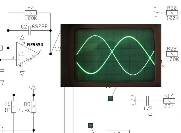

                    2. I made a DD coil for my IDX-PRO (DIY version), but my shield was made of aluminum foil. I was able to null it with a scope, but the sensitivity was terrible. I then removed the shield and the sensitivity is even worse!
                    Aim for a null <350mV
                    The phase of the preamp out WRT to the Tx coil volts should look likr this for a DD.

                    When I put a piece of metal, the RX amplitude doesn't change much at all, unless I get the metal really close.
                    Thats kinda normal, a good lump close will change the level but is not practical for tuning up.
                    The way I understand, the coil is in balance and the RX is zero until a metal comes along. That breaks the balance and the RX jumps to non-zero value.
                    Yes this is right, the rate of change of signal level is important - A static large signal wont go though, ( like the Leaked Tx signal ) the filter amps after the detectors are high gain differentiators centred at 8Hz

                      Wow, thanks, guys! Great answers. Golfnut, so you are saying that the rate of change is actually important, so I don't just measure the signal at RX and if it grows when the metal is present, it is good? I will put the shielding back on tomorrow, and I will try and null it and actually test it on an actual IDX. Just to make sure - you are saying the <350mV is ok on the actual coil? Isn't it a bit too big? Or are you saying it is at the output of the first opamp?
                        It is at the output of the preamp. Results at a bare oscilloscope are deceiving when you reach fine tuning stage, as the impedance of a probe is often higher, and capacitive couplings play differently. As lower as better, but don't expect to reach 0 because it is near impossible, and not at all necessary. It is important to have it low because of the op amp distortions that spoil detection. Your target may be at nanovolt scale, but if noise injection due to distortion is in microvolt scale, you can't reach it, and your depth suffers.

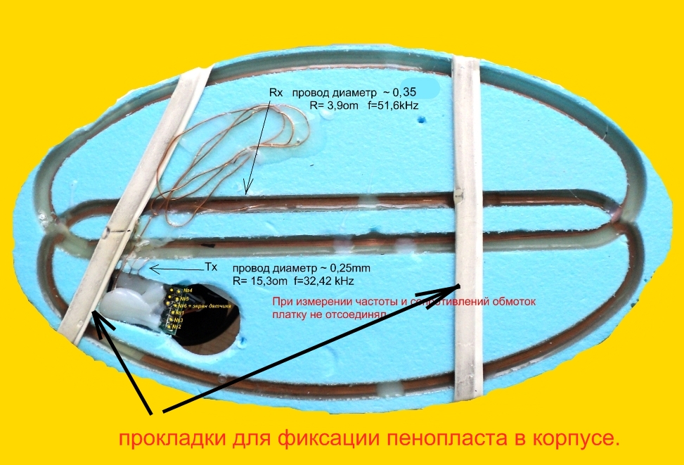

                            this document has not THE MAIN - Know-How. without know-how every thing is not working (that you have see from topickiller posting). WHERE in coil design is a tuning winding? it is absent. the document is nonsence. a firm coil HAS the tuning winding because you are not able to reach the good balance without the winding.
                              As you showed in your diagram, it is a good idea to leave one loose turn for fine tuning. However, a lot of amateur builders don't do that, and with careful adjustments it is possible to null the coil without it. BUT ... as many have found; once the epoxy has cured, the null is quite often lost. In that case, a tuning winding is definitely recommended.
