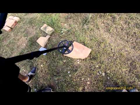

    I had the chance to get a used Nexus Standard SE with the double 9" and a double 6" coil. I like to try different technologies so i done the deal.
    First tests of the nexus are very impressive. So it is my first "see through iron" VLF machine.
    I have done a short video. The silver coin is a 1 oz .999 fine silver. The iron-pice is 7x2.5 cm.
    http://http://youtu.be/Ya5uH3jYUeg
    I´m new with the nexus and have not found a lot for handling and so on on the internet. So feel free to post experiences, tips and settings for this detector.
    I have found some coins, buttons and musket balls on the first outdoor test with the 2x9"coil. And it is very sensitiv for small pieces too.
    One musket ball was together with a nail in a lump of dirt.

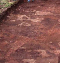

    Today i had a chance to go on an archeological excavation and search with the nexus in prospecting stripes. Such a strip is around 2-3 m wide and 50-70 cm deep unearthed.I also try the Lobo St with Mod (GB in Disc) and the explorer SE. Only the nexus could handle the changing ground conditions (herd provide, post holes, trash pits, from sandy to loamy,...) and give a noticeable signal. The other detectors gave for every groundchange a "dig me" signal. The nexus have it done similar but very weak. If there was an object than it came a very strong signal. Only the disc was lacking, but this is no problem. In this depht you dig all what give a "beep".

              For better understanding i have searched a picture in the internet, where you se such an archeological prospecting stripe. I used a different machines had set up each detector and then go in this strip. With the Explorer and the modded lobo i heard with every crossing from one ground to the other (light to dark brown and so on, see picture) a positiv signal (i name it phantomsignals). It was not only a slightly signal but a repeatable strong signal. I had dig such phantomsignals also. With minimal Sens on the explorer and lobo it was not so strong but still a "dig" signal. With the nexus it was possible to set the GB such, that you hear the phantomsignals also, but only similar to a slight treshold tone changing. In this setting objects gave a clear signal. So i could distinguish from groundsignals to objectsignals which i could not with the other detectors. Click image for larger version
              The "see trough iron" is not the correct term, it is a phrase. Therefor it starts and ends with ". The nexus is not so prone to masking effects how other detectors which i have used. It is more a "see close by" the iron. Don´t know if the deus could do this also, but i suspect it. Also the lobo with small coil can do it better than the explorer but not so good how the nexus with it´s doubble 9" coil (which is big).
              I think my grammar is not so good, so forgive me.

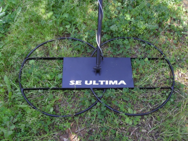

                sorry , but this was the case: "Nexus Standard MKII" with "SE Ultima" coil in red clay (terra rossa).
                  [ATTACH]31741[/ATTACH]
                  From this picture I can tell this SE Ultima coil was manufactured relatively recently. Since we sell very few of these coils how come we don't know about you?
                  If you had any problems with this detector was it not the right thing to do to contact us and discuss the GB issues? You seem to have good English, so why not call us, but come here to talk?
                  How many people you think in the entire world will be able to tell you what to do with this combination?
                  Let me be as clear as I can.
                  With Nexus the larger coils have much less GB problems than the small ones. This is because the larger coils in our designs are of the same Q as the small ones and use the same oscillator Voltage swing.
                  If you had problems with GB in this case it is entirely caused by lack of knowledge of how these big things operate. It is well explained in the User Manual, not that many bother to ever read it.
                  First step to getting things right is to turn the sensitivity control down. Do this and see what happens.

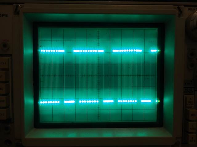

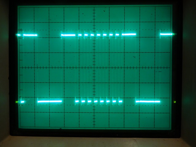

                      Hi crane!
                      I have a picturer for you from TX of Explorer SE.
Name:	Minelab 5V 200us klein.jpg
ID:	342151Click image for larger version
Name:	Minelab 5V 100us klein.jpg
                      If you look at this, what waveform did you see? According to your statement is the explorer no VLF also. But what than?
                        Yes the Explorer transmits a continuous rectangular waveform.
                        As stated in at least one paper, the term "time domain" implies that the method employed is best analysed in terms of the temporal evolution of signals, just as "frequency domain" devices are best analysed in terms of the frequency and phase of signals.
                        FBS is an example of pulsed time domain, but some CW detectors using a pulsed tx waveform are best described using frequency domain art because they only measure the amplititude and phase of the receive signal, similar to vlf.
