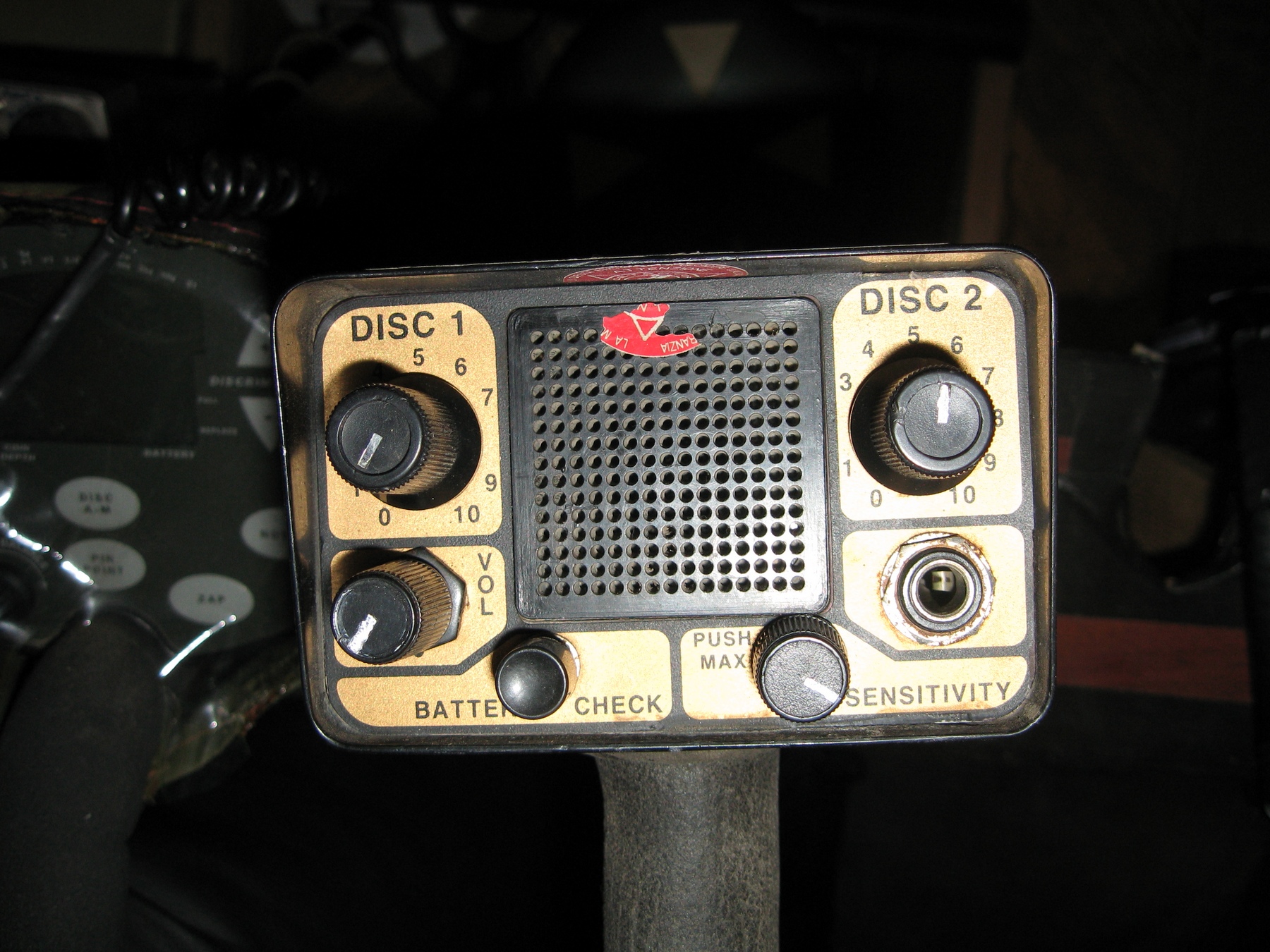

    I have bought a second hand Fisher 1266X.I have question about sens poti switch: when i measure two light green wires (i pull the poti or push the poti) there always 0 ohm ,so the switch is broken, allways connected.

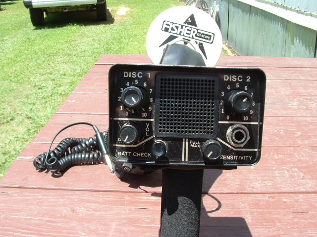

    In what position should be max sensitivity when the switch is open or closed.On my detector is written Push MAX but i have picture from this forum with PullMAX label.Or is that different machine?.
          with black color panel - fisher 1265. while schematics are similar for both 1265 and 1266.

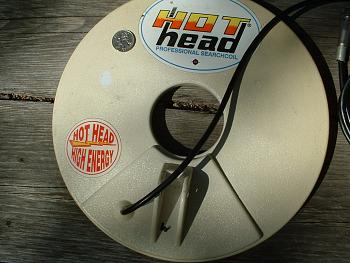

                I have a 11 Hot Head coil on it.Like that one on the picture.

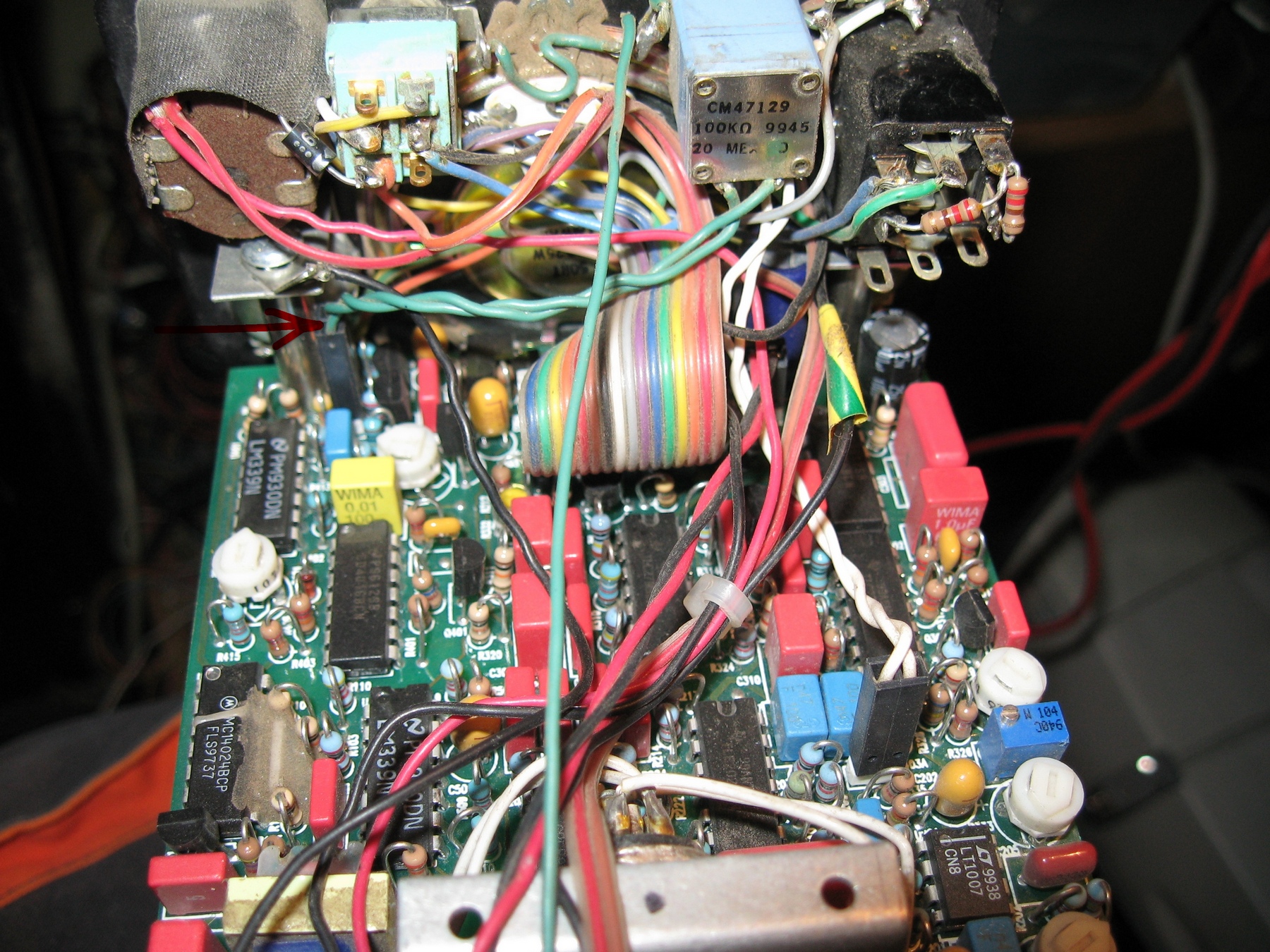

                  give please pics the YOUR housing inside. all I see here only files from the DVD archive. people also answer by the files. all that seems me only some kinda
                  ping-pong game round - you put - they put - you put - they put. SOMETHING I have NOT GIVE.
