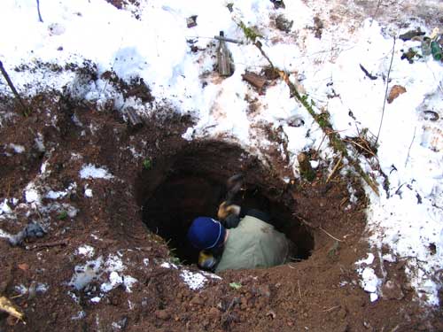

                              btw. distances are looking pretty short in air but here you can see how much work it can be:
                              The end of the steel-part was "only" ca. 50cm below ground.... (size ca. 10cm broad)
                              Are you ready for digging some of these holes?
                              http://www.mirrorcreator.com/files/Q...2010.avi_links
