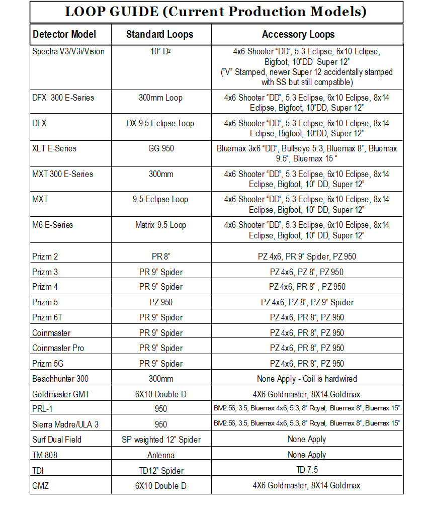

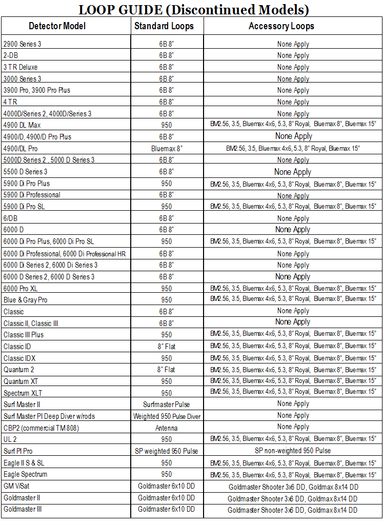

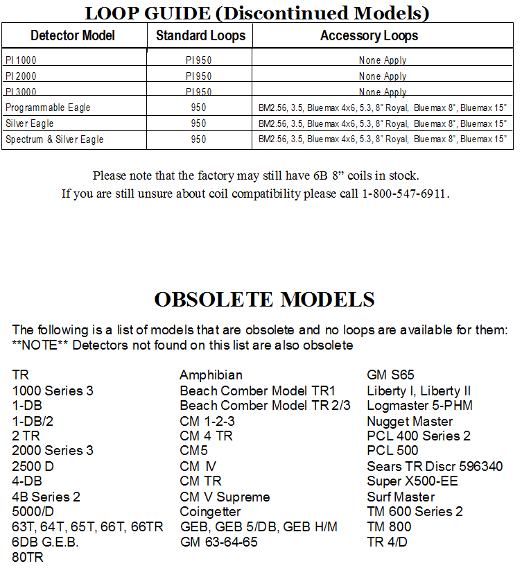

                        Loop Guide.pdf
                          my pic and you can mate http://storage9.static.itmages.ru/i/...81554731f8.jpg
Name:	Loop Guide page 3.png
ID:	342193Click image for larger version
Name:	Loop guide page 2.png
ID:	342192Click image for larger version
Name:	Loop guide page 1.png

                              Whites recommend the 6B
                              Where as on the Whites forum by an administrator it's D4 and D5
