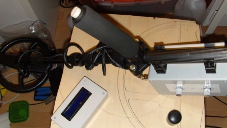

    Hello,
    i have interest in a new desgin for my baracuda pi.
    For silent search i would connect something like a VU Meter to the Audio Output.
    I would do this with a 1602lcd or the Nokia display and a arduino nano if possible.
    have searched the Internet but found no full guides ho to do a simple meter with a display and arduino.
    Most Projects have bad documentation, or you have to buy a shield.
    So i Need help for this Project because i am a coding noob.
    idea was to read analog in of arduino set the measured voltage in relation of the measur range of arduino (i think 5V was 100%) then send the datas to the lcd , incase of 1602 there a 16 blocks which each 5 rows
    so you can read the Signal in high Resolution of 80 lines
    or for the Nokia Display as numerous Display.
    any idea how to realize this?
    thanks much for reading
    hello again
    i got some help on German arduino Forum
    they write me a code, and also gave me the info that it exists a library for arduino lcdbargraph on arduino cc
    so it should be possible to build a simple mono bargraph for replacement of Audio the next weeks
    i only have to design a little pcb for i/o port protection (max 5v) and direct Clip on for arduino nano to 1602 lcd
      bernte_one,
      1602 usually has a controller that only allows 8 custom chars, that will give you graph 40x8 pixels (8 chars each 5x8 if I remember correctly; this is how I used it in VDI for TGSL). Its trivial to do the graph once you find the code. You can't just use 1602 like graphical LCD. Or you can have nice "char" or "block" based graph of decent size that will look good.
      I tried popular Nokia phone LCD I2C for arduino; its cheap; low res, (is it like 48x96?), not too big, light; but it works OK. If you don't need a lot of info on the screen at this same time should be fine. There are graphics libs that work with it.

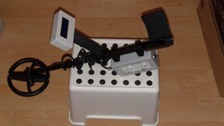

            i had in mind to make a fast test Switch (crap check button)
            so i can switch to the setting by one knob insted of Setting delay and threshold each time
              head some minutes free time to do my hobby this weekend

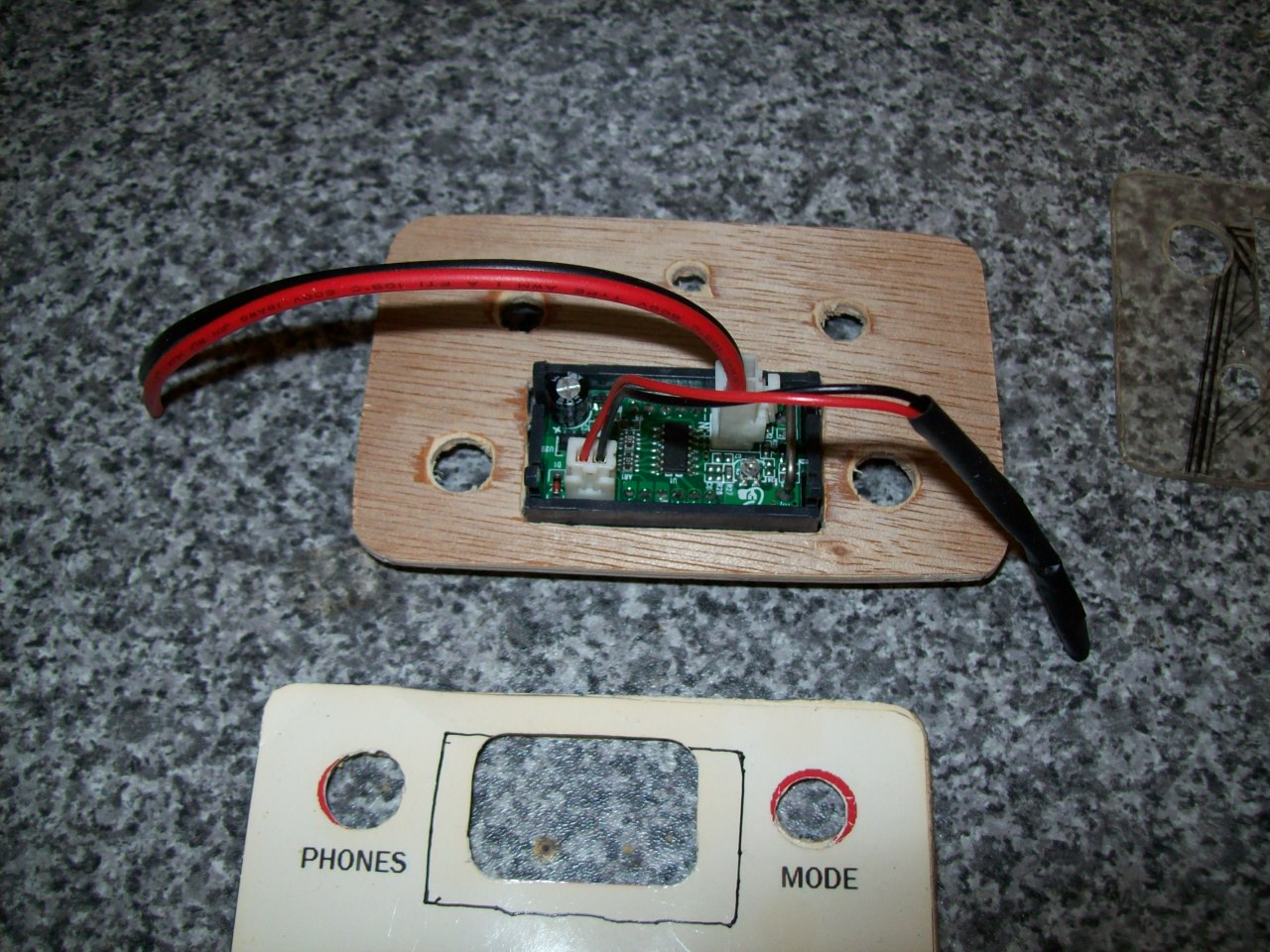

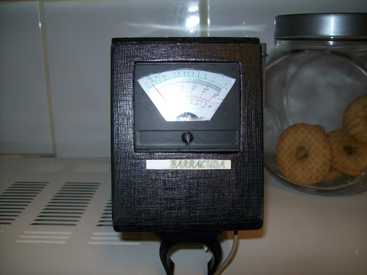

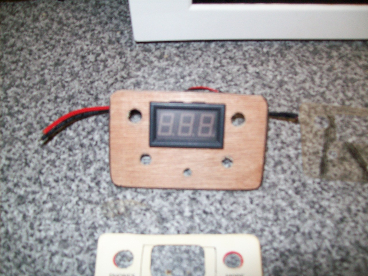

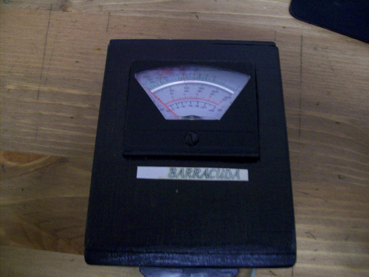

                hi bernte, as i have said many times on here i am profoundly deaf in one ear(totally), so i usually only have one cup on my head phones, i have played around with an analogue meter on my barracuda, connecting it instead of the led, the way the led is wired on the barracuda is good for a meter.
                i have a digital umeter i'm going to fit to the mini pulse, so i would be interested in your project.

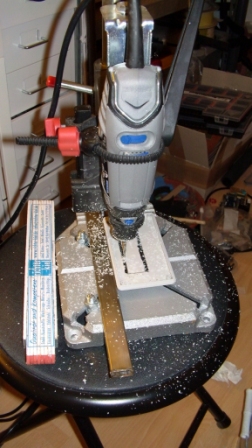

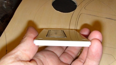

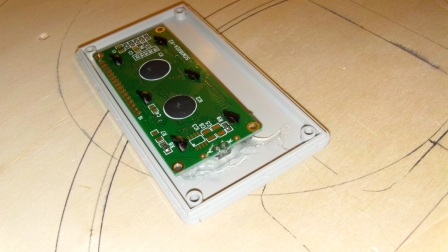

                  It can be so easy. I will never cut the hole for the Lcd with a saw;-) It was a real adventure to cut it accurate with the saw;-) It makes me 3 years older. I will do it this way next time!
                  Good solution!
