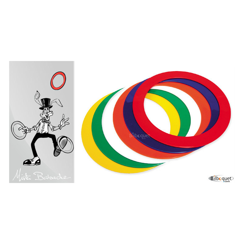

                hab an idea for a basket coil body for everybody who is to lazy to cut plastic rings (like me)
                search the net for jonglage rings
                  I guess you mean "juggling rings"?
