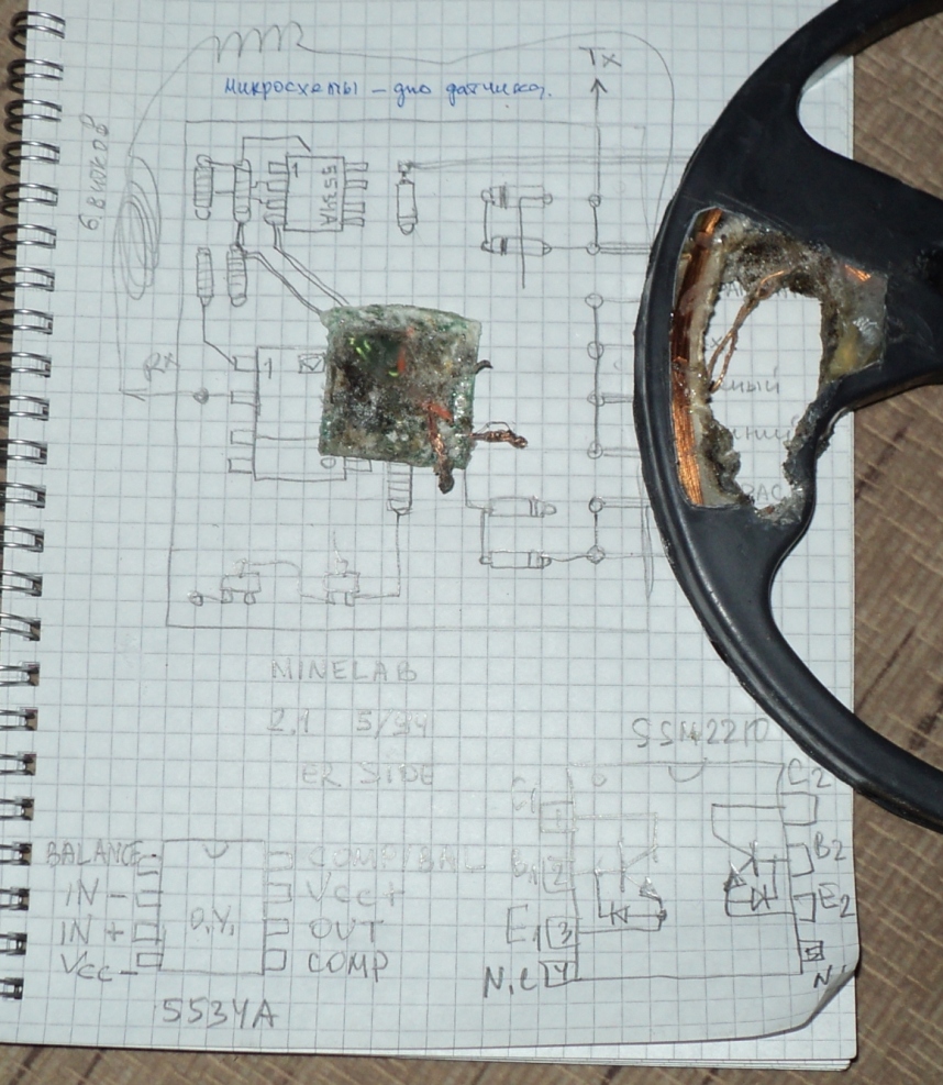

    Hi Gurus, I'm trying to build a Minelab Sovereing coil but I can't locate the pre-amp circuit schematic, I've tried to ask Coiltek and Minelab without reply.
    Where I can get the pre-amp circuit?.

    The Sovereign Coil as you know has a Pre Amp.
    The beauty of the design is that to power the Pre Amp it 'Robs' the Power off the Transmit Coil.
    Setting up a small coil to get the AC Voltage could be tricky so I suggest aligning the coil with an AC Power Supply to the Pre Amp first then afterwards removing it and setting up the small coil.
    Due to limitations I can only send one Photo.

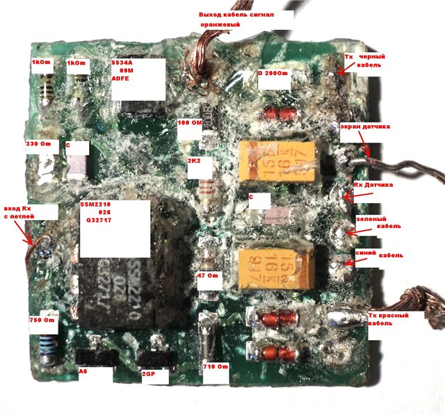

    This will show the Pre Amp Board but if you give me your E Mail address I will send you the Photo showing the Coupling Coil.
    Happy building.
    Peter.

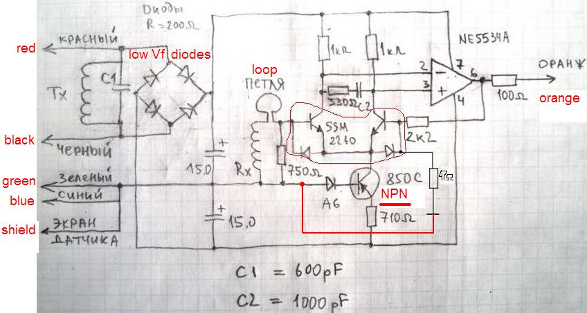

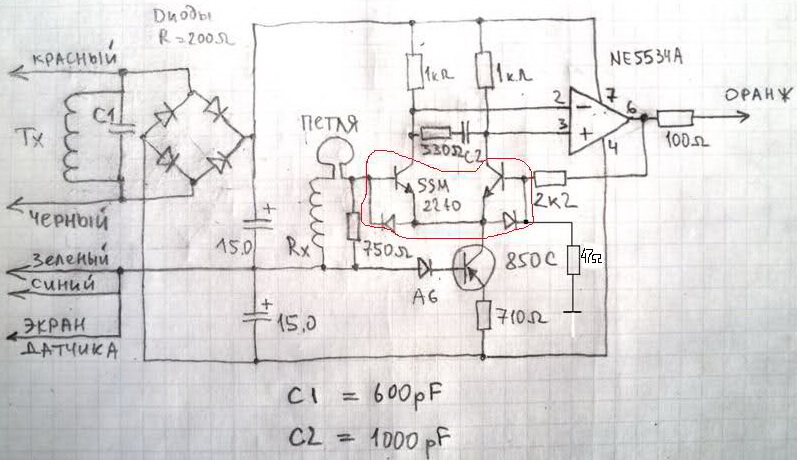

        Re: Minelab pre-amp
        Hi Solmer
        With the two images of the pre-amp PCB and the datasheet of the LM394 (see application sample page 4) you can make your own Sovereing pre-amp circuit. Exchange the LM112 (appl. note) with a low noise NE5534A and add the power spupply circuit (small coil, protection diodes, bridge rectifirer, cap's).
        Check it out!
        Chris

          this is not my Home Work i see some progress in the matter and only bring the info to here. enjoy

              KT315, I think 850C is an NPN transistor (suchlike KT315 :-).
                Roger! you are right... 2Gp is BC850C NPN. an author has to fix this, I hope he reads... thanks!
