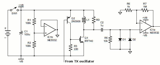

    Here's a snippet of the PI-5 schematic from ITMD that uses an NMOS to drive the coil, and creates a dual voltage supply for the opamp from a single battery pack.
      Ok? I see how the diode arangement and how i should bring the second end to the ground, but how can i set the offset of the opamp (by the way i do not have an NE5532 opamp) so i want to use ones that i have laying around (soic8/sot23-5).

        unfortunately the Pi - 5 schematic was pointed out to be drawn wrong months ago !!!
        the arrangement around the back to back diodes send all fly-back to the rail splitting op-amp.......
        it may not like it..........
        poss best print another diagram, sorry George.
            I think you'll find that the schematic is correct.
            You're probably getting confused with the generic "Inverting Opamp" diagram in Fig 11-11 (Chapter 11, page 149), where the bottom end of the clamping diodes should be connected to 0V, and not to the negative battery terminal. The way it is drawn at the moment will cause the preamp output to be driven up to the positive supply rail.
            The PI-5 design in Chapter 12 on page 171.

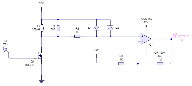

                well, thought I was right................
                just run a simulation on the Pi-5 ............
                and a spike of 7.75 amps of fly-back goes straight into the output
                of the rail splitting op-amp.
                firstly, there is no "in-line " resistor after the coil,
                secondly the protection diodes should be after the in-line resistor and go to whatever voltage the coil is
                powered from.
                I am only an amateur, but have learnt much over the last 6 years of tinkering master.........
                rekon my inserted picture below is how the Pi-5 was intended to look.......
                could be wrong I guess......

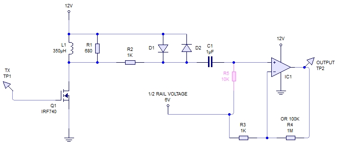

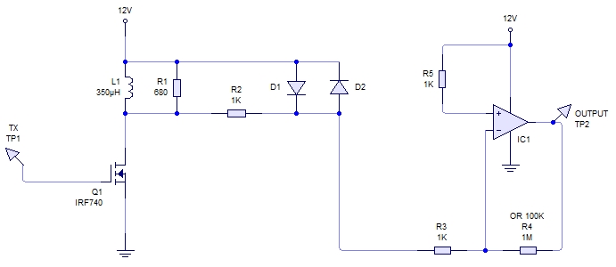

                below is 2 "standard" arrangements of Pi front ends to help out xp-cam
                on his journey...............(assume he's a he, may not be.......)
                on the inverting diagram, the 1k on the op-amp to the top rail may not be needed,
                esp if only amplified lightly, ie: 100x.
                but can be used with another resistor to the neg rail to "tweek" the off-set.
                just in case the op-amp used doesn't have that facility.

                    xpcam,
                    your feedback resistor is still going to the non-inverting (+) input of the (2nd) op-amp,
                    needs to be to the inverting (-) input.
                    you need to power the op-amps (usually) with more voltage than the signal it's going
                    to see,
                    ie: more than 12v+
                    can't see the need for the 1st op-amp as a voltage follower.
                    and your upper 10k to +12v doesn't need to be there,
                    remove and link to +12v
                    please try either the non inverting or inverting "standard" set-ups like I posted
                    earlier.
                    there's lots of ways to arrange a Pi front end that work,
                    the ones I have posted are but just a few.
                    oh, your bottom 10k just before the diodes will work,
                    but from experience its going to be as "noisey as hell"
                    most designs use 1k, or less.

                              Xpcam,I'm not surprised it don't work !!!On your bread board, and this is just a guess.......You have fed your signal through the 1k,Then into the diodes........But,The diodes should then go to + rail,Not your opamp input !!!So,Your opamp has now seen full flyback voltage.
