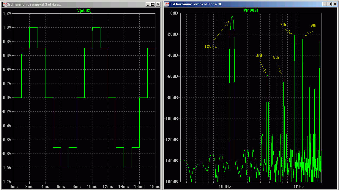

            Regarding the 3rd and 5th removal, see the attached picture. As digital filtering is basically a convolution, you may treat each filter's mask as a signal source and see how it performs in frequency domain by observing FFT. If you have any problems following the previous sentence, simply observe the picture.
            As you may see, the 3rd is suppressed by almost 60dB, and 5th even a bit more. Not bad for a simple scheme.
              So what program did you use to model this? The first picture is obviously a model of the sampling applied to a wave form. The second is an fft of that sampling, correct? I presume the 125 is an artifact of something in the model, since this code actually runs around 7.1K.
              So what about the algorithm supresses the 3rd and 5th harmonics. And how does this compare to a band pass filter?

                    • #70
                      I think the sim is Pspice
                      it is free on Linear Technology site
                      • #71
                        I'm sure Davor will confirm that it's LTSpice.
                              It was LTspice, a free spice program that is used a lot among amateurs and beyond.
                              I used 1ms per sample for simplicity, so 8 samples in a period gets you to 125Hz.
                              The peak sample has amplitude 1, the smaller ones have 0.71, and there is a zero. These resemble the 3rd removal additions. The negative side is for negative samples, and why I did it this way should require a semester in signal processing, so just take it as is.
                              The point is that if you shove a square signal in, after this crude digital filter it will lose the most of the 3rd and 5th, which makes a square Tx a lot more appealing. You may imagine the square signal as simple as the polarity of samples.
