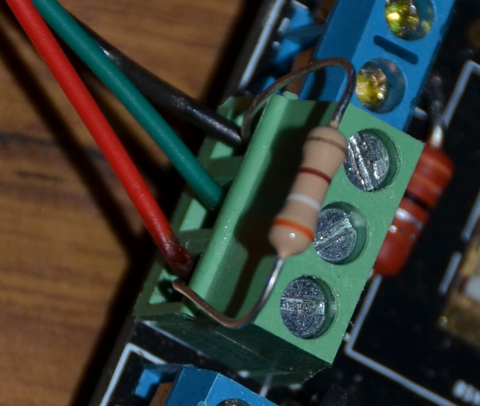

                  Hi Guys,
                  Regarding the Crossbow build.
                  Where is everyone fitting the damping resistor? In my first build box I have the damping resistor inside the box on the back of the coil socket. But if I attach a different coil which may need a different damping resistor it means taking the box apart to change the value.
                  If I put the resistor inside the plug there isnt enough room because the coax is a little thick. So I was wondering if everyone just sets this resistor for one coil and then just ignore the discrepancies if fitting other coils? Or is everyone putting the resistors inside the coil housing? Thats ok for homebuilt coils but what about bought coils? Open to suggestions.
                  Chris
                    If fitting a resistor in the plug is a problem because of the size of the resistor, might it be possible to fit a resistor that's the highest value of what your coils need, inside the control-box, then just add a parallel resistor in the coil plug. This will be lower power requirement, so can be smaller.
                    EG. coils need 300, 320, 390 Ohms. Put 390 in the box, then in the '320' coil plug put 1K8, in the '300' coil plug, fit 1K3.
                      The problem I seem to be having is the coax is 6mm diameter, then I have a few links because they are mono coils, then getting a resistor in there without things shorting. Its a 5 pin plug so terminals are small and the terminals also move about, maybe I should look for better quality plugs, might help.
                        Hi Chris, I just fasten it in with the pcb coil connector, as imaged below. It seems to work okay for me. I'm not familiar with technical parameters relating to damping resistors. Why would you require additional resistors in the coil and pcb plugs if one is installed at the board? Image attached.

                          Hi Gord,
                          The different coils I have made are all 500uH but they all seem to need a different value damping resisitor, maybe the capacitance is a little different. But I like to set the DR so that the coil is almost ringing and is not being over damped. It seems to make them more sensitive. Al the moment mine is inside the box, but I want to change this so I dont have to keep opening the box up.
                            Hello Chris (Not very well here) This popped up in my mail box, I do not know how current it is. I planned my DR in the search coil so the DR and coil are a pair, A different coil then has its own DR, built in. I think that is the same as the Teknetics T2 which has a sealed access on the coil housing. (I may be wrong), Further, I have done nothing with the boards or coils recently as I am up and down, mostly down.
                              Hi Ken,
                              The reason I put the DR in the box originally was so when I had made new boards I could then adjust the DR and use the coils on different boards.
                              I found that a coil which was ok on one board would ring on another board, so needed adjustment. I dont know why.
