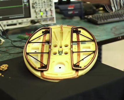

    What do you think about this coil.

    mikebg proposed, here on forum, such coil configuration as the best years ago.
    Otherwise known from old patents.

        thats a serious wad of litz in the middle - probably not resonant Tx
          I wonder how they hold that bundle together ? Must be bonded somehow ?
          I have seen posts by Stefan (may have spelling wrong), he gives a lot of tips for building fast low capacitance type coils. And in one of his posts he describes this square/recatangular profile, or rather, describes winding a layer, followed by insulation material, repeated until the bundle contains the requisite number of total turns.
          That screenshot of their engineering example doesnt appear to have inter-layer insulation. Still a very interesting image to look at. There is a video tour of Garretts workshops online. They also use similar black plastic bundle spools in some of their coils. Guess this offers consistency and repeatability.

                          Now, maybe you do not have to list the forum references, but the fact is that the "obvious" category is formed by the opinion of the technicians versed in the art, and those tend to frequent the technical fora, such as this one. E.g. if you ask about the new GPZ coil, many people will instantly recognise the design mikebg promoted here.
