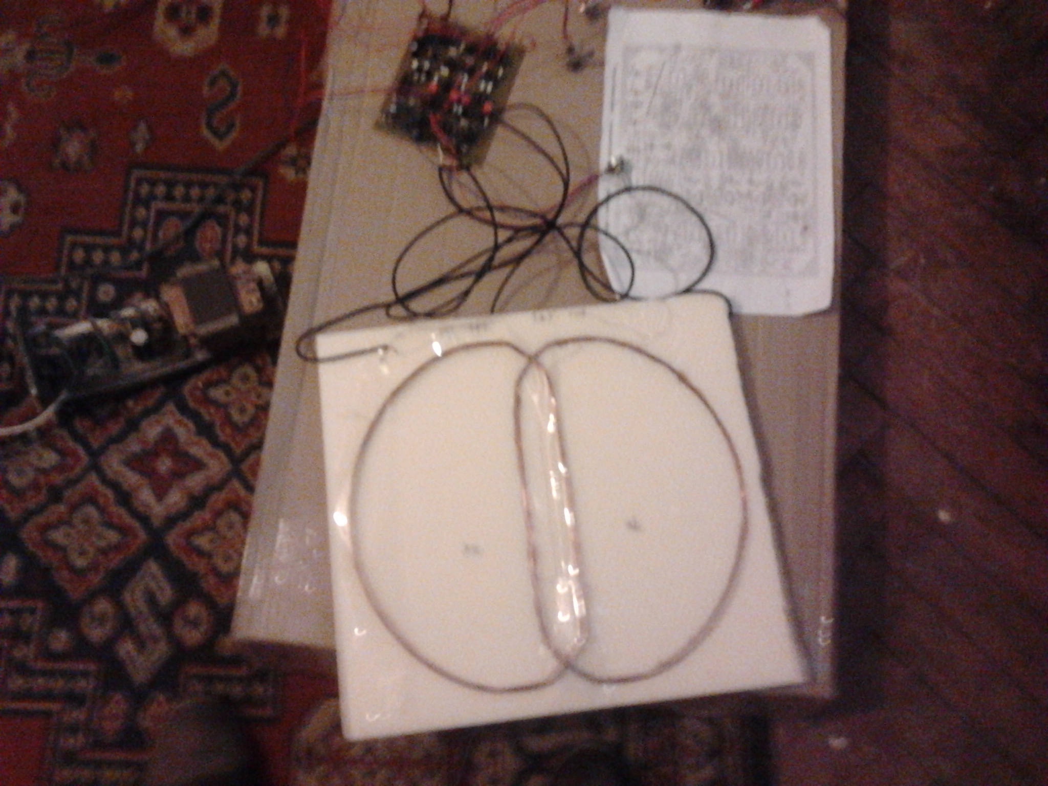

            coil
            best coil for me..Click image for larger version
ID:	342936Click image for larger version
ID:	342937, ( si atentie la lege..)
              the DD .. nice and congrats .. i was thinking the same but i really want to start things slow
              pay atention the all advices (evident .. nici in gradina bunicii nu ma gandesc sa-l testez)
              next week i'll gather all the parts i need for the receiver.
              ps. can the mini pulse work with garrett DD ? (the standard euroAce coil)

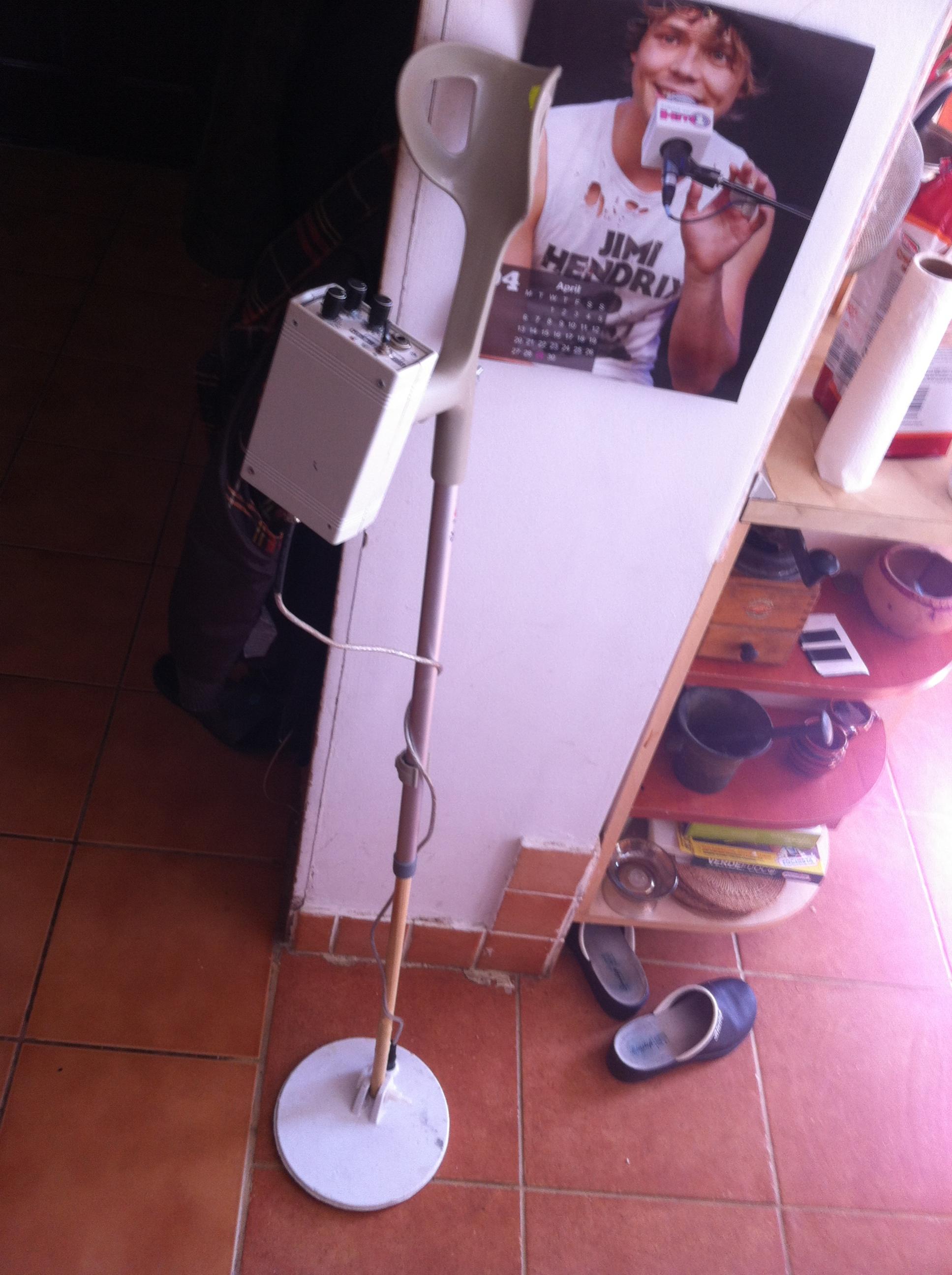

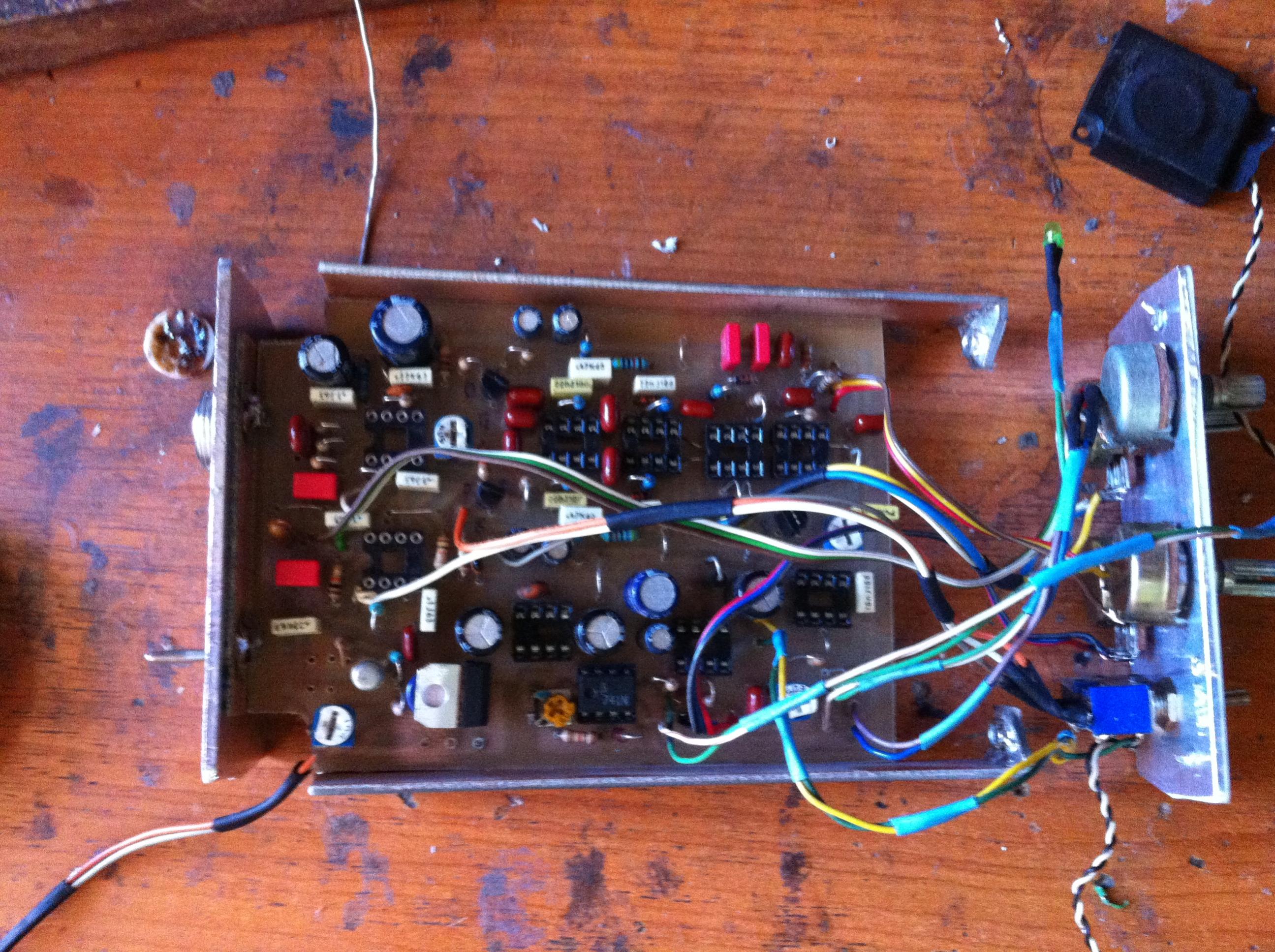

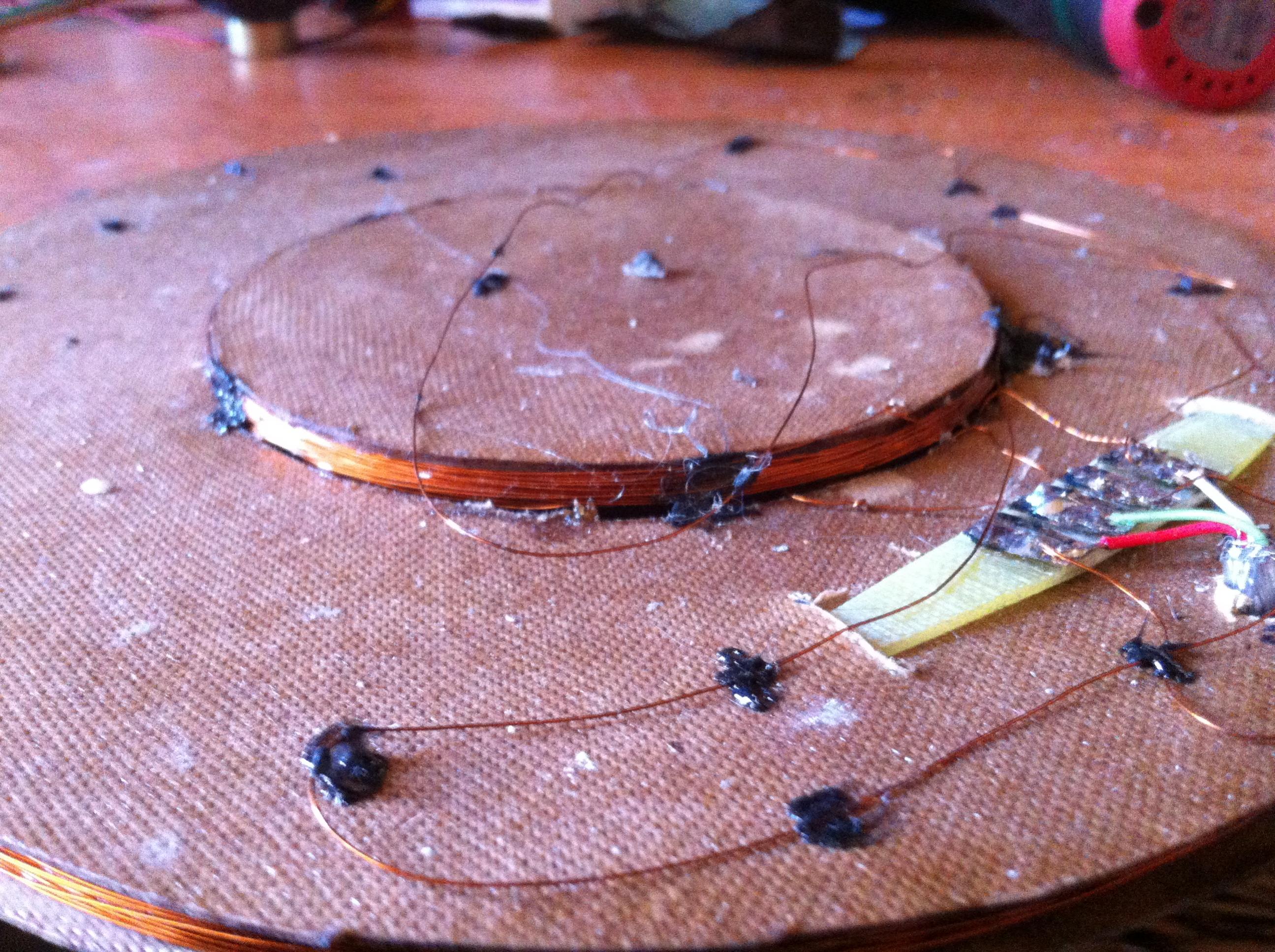

                    For Cataliniliescu and Nokia: my Tgsl whit dfbowers(tnx for help)Click image for larger version
ID:	342940Click image for larger version
ID:	342941Click image for larger version
ID:	342942 concentric coil working excelent
                      congrats noro .. you made the circuit board by your self ?

                            yes ,using spint layout program for pcb
