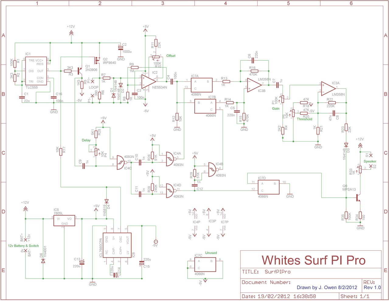

                    Have a look at the Surf-PI schematic (attached). You will see that ICs 4 and 7 are both driven from +/- 5V, so there should be no problem with the circuit. Perhaps there's a mistake in your PCB layout.

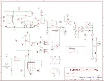

                      Qiaozhi, you posted to low resolution, to recognize something.
                      Do you have this in better resolution?
                        That's strange. The original is not that small, and should have been 122.3kB.
                        Here it is again as a png file.
