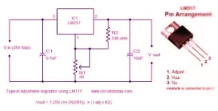

          I would make a simple adjustable constant current source with a LM317 regulator and a pot to adjust the current limit. The info is on the data sheet. Safest way to do it. Measure the voltage across the led when the brightness appears normal.
            DavidB,
            See the attachment below. Is that what you are suggesting ?
            Sorry the picture isn't focused better; hope you can make out the details. :examine
            ToddB

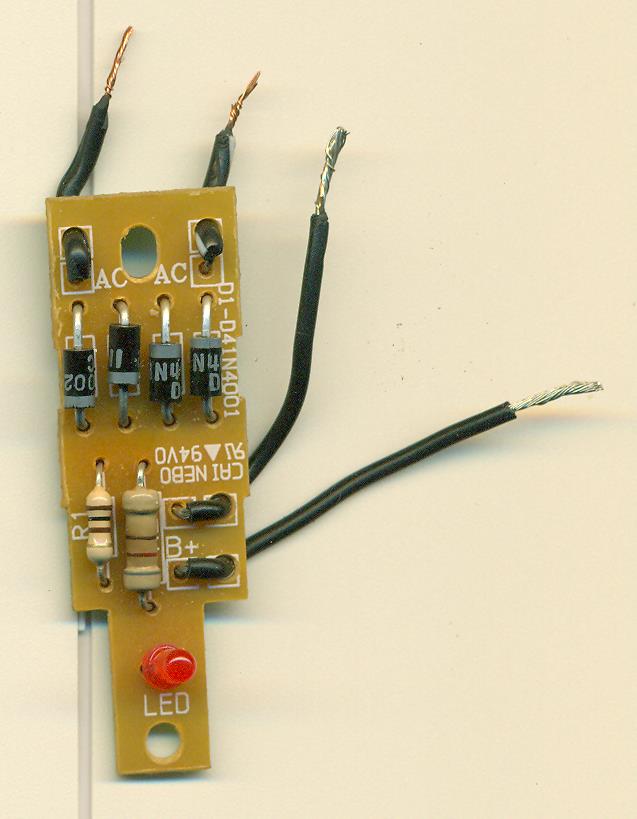

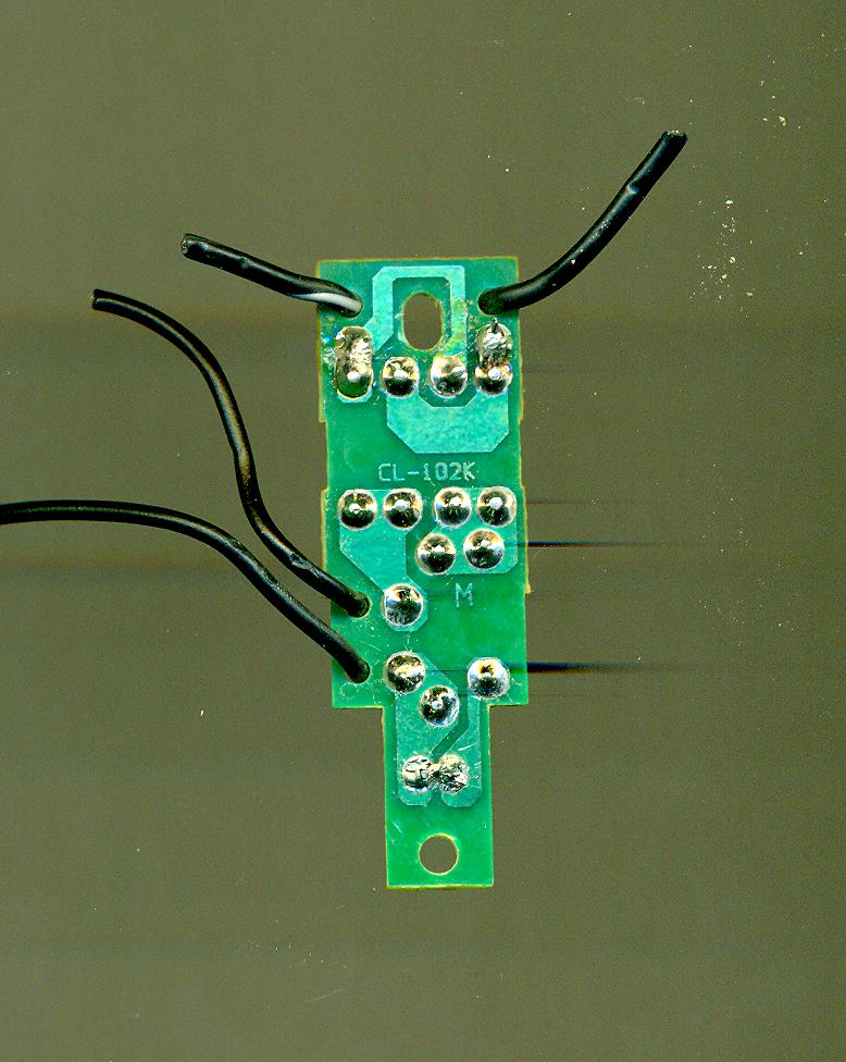

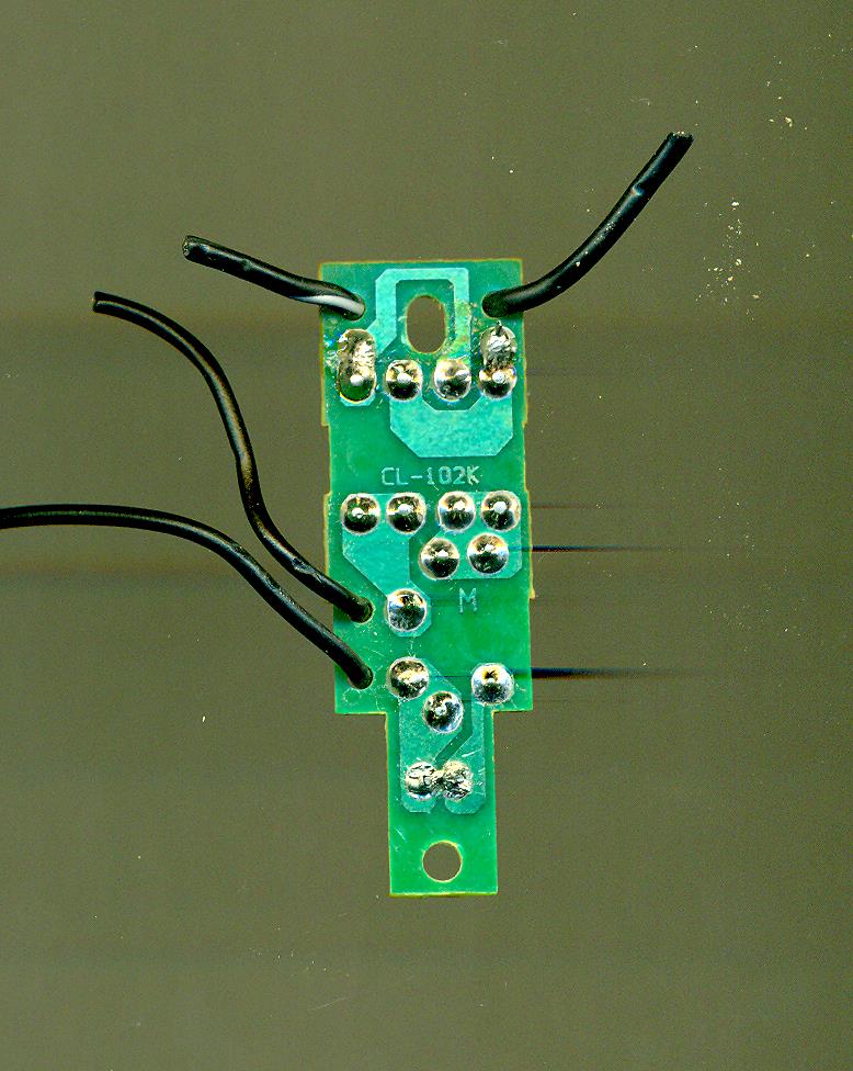

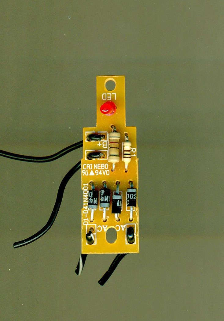

              Attached are two pictures showing Top and Bottom views of a small pcb I scavenged from a trashed transformer.
              I went to Mouser Electronics @ http://www.mouser.com/catalog/catalogusd/647/170.pdf and looking at the selection of LEDs I noticed that leds come in various diameters, like 3mm/0.118", 4mm/0.158" and 5mm/0.197".
              I also noticed that the following leds listed on the mouse chart had Vf (forward volts) almost identical, regardless of the variation in diameter.
              3mm/0.118", Red/Grn, Diff, 2.0/2.05 Vf
              4mm/0.158", Red, Diff, 2.1 Vf
              5mm/0.197", Red, Diff, 2.1 Vf
              I'm not saying that the above comparison would hold true for Vf in every case if group comparisons were made with different types of leds , as I haven't done a thorough review. But the above example indicates that the diameter of leds has little to no affect on the Vf , at least for this particular group. In your experience, have you found this to be true ?
              I ran across the following tutorial document on the Internet and it includes formulas, such as R series = (V - V f ) / If, where Rseries is the resistor value in ohms, V is the supply voltage, Vf is the voltage drop across the LED and If is the current the LED should see. I thought this might help someone who needs details on LEDs.
              Title: Notes on LEDs, by W.E. Johns @ http://www.gizmology.net/LEDs.htm
              Thanks for contributing to my knowledge !
              ToddB66

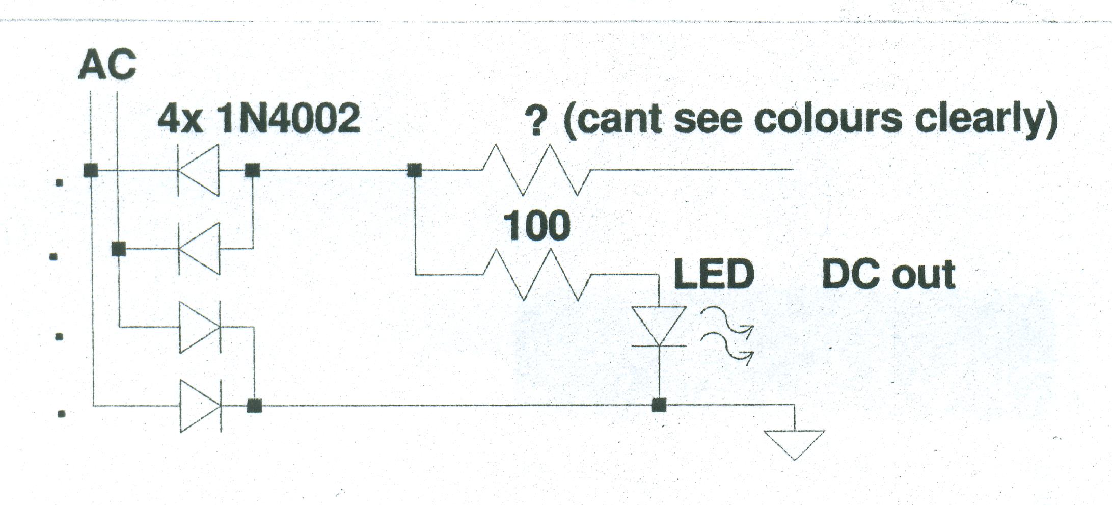

                This is the circuit for your board. I cant see the resistor colours clearly on your photo but was it was a 5v supply?
                I just noticed that even though it says 1N4001 on the board for the diodes, they have used a higher voltage diode (1N4002)
                circuit.pdf
                  I wouldnt get too hung up on voltage drops for LED's. There is no hard and fast rule as LEDs all seem to be a little different. From memory it was around 470 ohms for 12v supply but you could use a 560 and it would be ok.

                      Hi CAS !
                      I can't say what the supply voltage was, as I put the torn-apart adapter in the trash some time ago, but I did jot down the adapter make and number and kept this information. It was a Black & Decker no. 200635HW. I tried to look up the supply voltage on the Internet using this description, but Google and Yahoo didn't provide anything, nor did the B&D Corporate website. I guess adapter 200635HW is obsolete; it was probably about 20 years old.

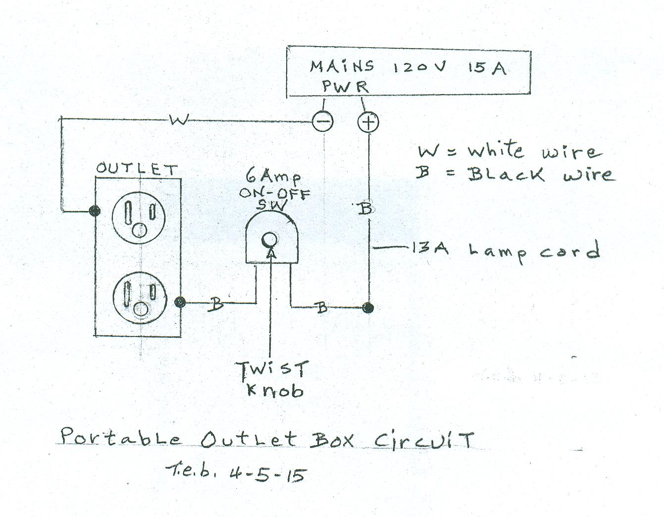

                      Attached below are photos of (a) your circuit sketch, the salvaged PCB from the B&D adapter 200635HW (b)Top and (c)Bottom and (d) a sketch I made of the circuit in my Portable Outlet Box, for reference. Concerning the note on your sketch "(can't see colours clearly), I had the same problem, especially with the third color to the right; even using my 10X eye loupe, I couldn't make a conclusive color choice on that band. So I checked both of the resistors on the salvaged PCB, the larger and the smaller one, with my DMM set in the Ohms position and below are the readings I got. Sorry I didn't get all of the attachments arranged properly to match this paragraph...I was having trouble with uploading (no fault of this website.).
                      Larger (and longer) resistor........ 99.5 Ohms Smaller and (shorter resistor)........ 8.3 Ohms
                      If possible, I would like to connect the PCB to my Portable Outlet Box circuit, so that the LED comes ON when the switch-knob is turned ON. Up until now, when I get the P.O.B. out I have to use a test light to check if it's ON. Could you please advise me on how to make the connections ?
                      Thanks much !
                      ToddB66

                              CAS,
                              This is an addendum to my post #11 (in quotes above).
                              With reference to the attached picture below showing the Top side of my PCB, I tested the rectifier diodes with my DMM set in diode mode and got the voltage readings listed below, while keeping the red positive test probe always touching the Anode lead of the diode. When I reversed the tester leads I always got O.L. on the meter display.
                              Starting with the diode at far-left and going from one diode to another toward the right, the readings were as listed below.
                              567 mv (0.567 Volts) at far-left
                              579 mv (0.579 Volts)
                              562 mv (0.562 Volts)
                              565 mv (0.565 Volts) at far-right
                              So with this information, i.e. my meter readings on both resistors plus the four rectifier diodes, can you advise me on making the connections as requested in the following paragraph (copied & pasted from my previous post.) ?
                              If possible, I would like to connect the PCB to my Portable Outlet Box circuit, so that the LED comes ON when the switch-knob is turned ON. Up until now, when I get the P.O.B. out I have to use a test light to check if it's ON . Could you please advise me on how to make the connections ?
                              Thanks again for your help !
                              ToddB66
