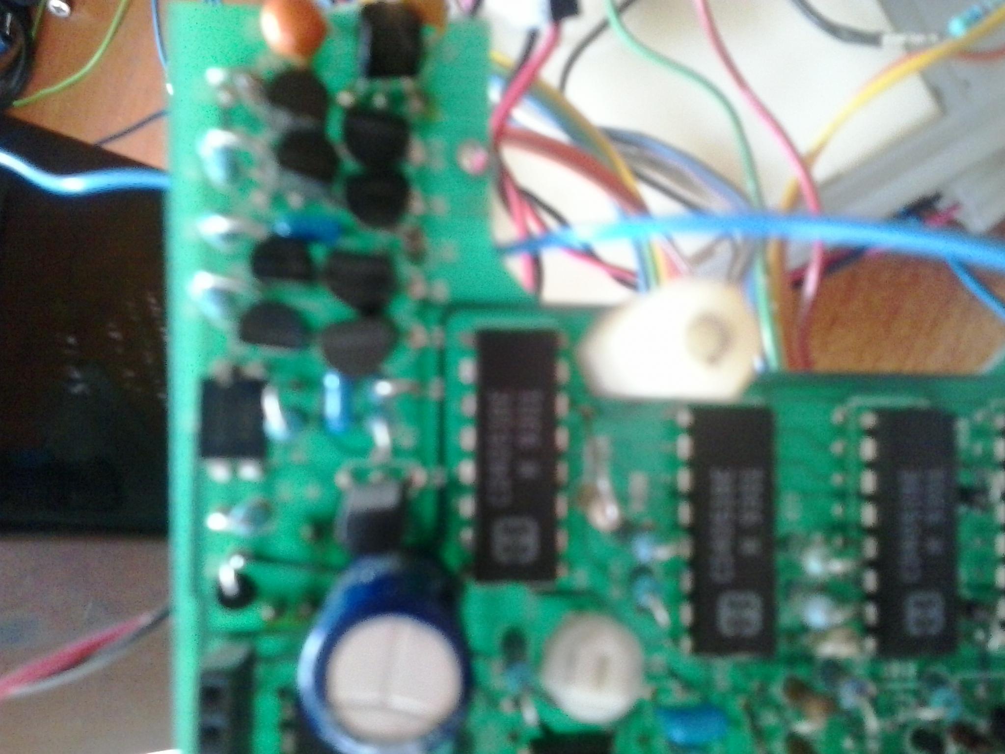

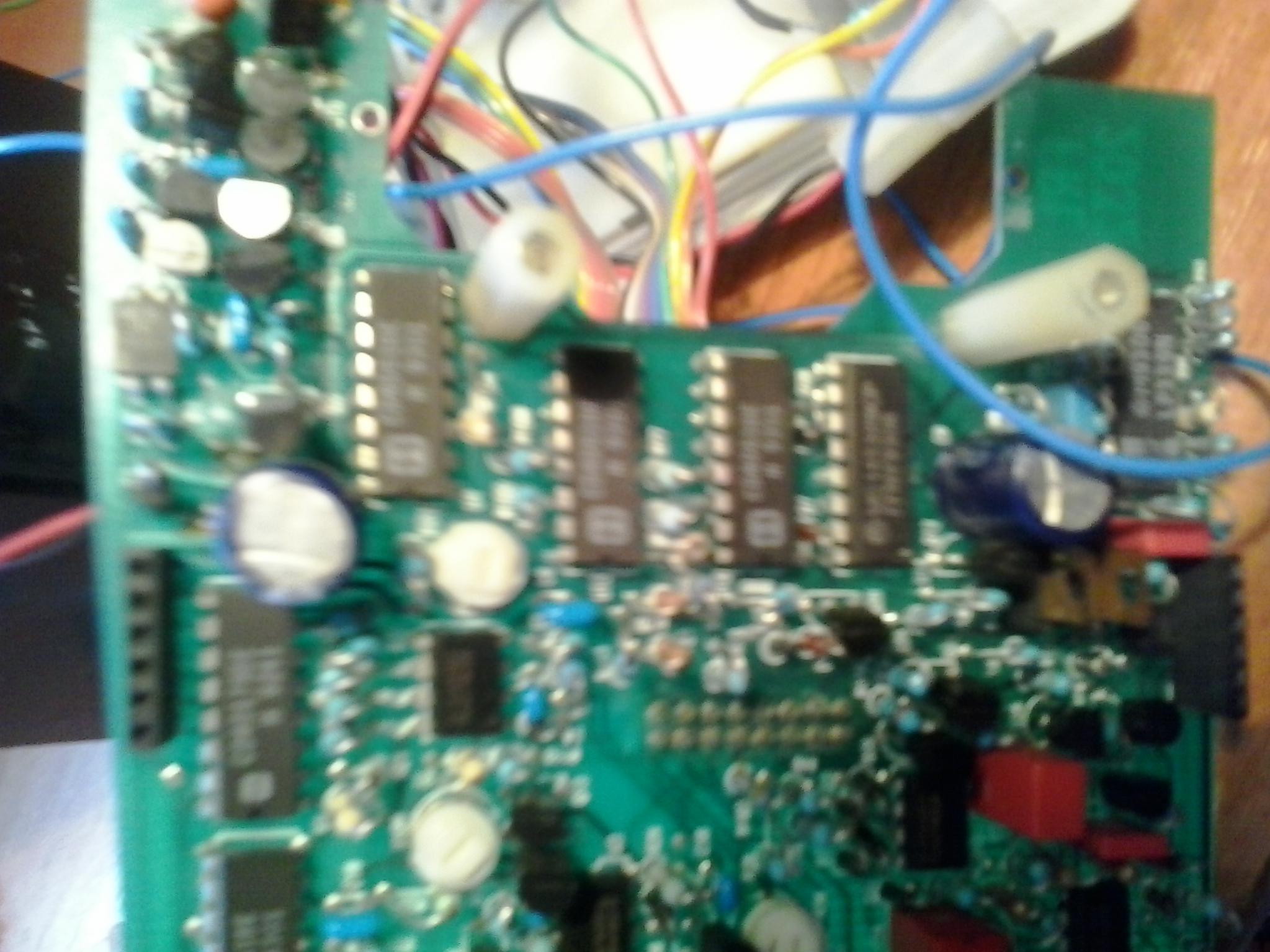

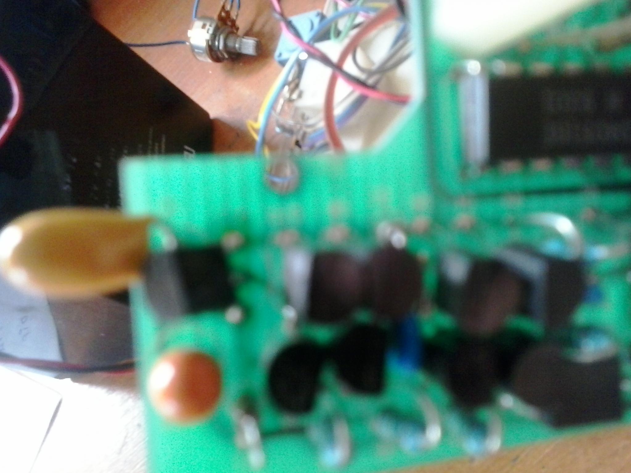

you do not understand ,I do not know who the original transistors !
for me has arrived with already Replaced transistors and that Q 2 = 2N5088 Q4 = bc 547 and Q11=bc517 ! I know it's not even replacement I had a long time ago Fiser CZ5 but we did not crossed my mind somewhere to write transistore which are !These certainly are not replacements !
OK, now I am confused. I made an error, I told you Q2,Q4 and Q1, not Q11. These are the power mosfets that drive the transmit coil.
Q11 is actually part of the pre-amp. Are you sure you meant Q11, and not Q1? Or did you mean Q12,Q14,Q11??
Zdravo VM6 ,neki iz Macve neznam tacno ko poslat mi je svi trimeri rastelovani i na tim mestima su zamenjeni ti tranzistori, ja sam davno imao fisera ali nisam zapisivao koji su tranzistori u pitanju !
Hello VM6, some of Macve do not know exactly who sent me all trimmers incorrectly adjustedand in those places were replaced by these transistors, I have long had Fiser but I'm not writing that transistors are at stake!
I think it is Q11 preamplifiers in tonal work and Q2 and Q4 !Originally posted by Skippy View PostOK, now I am confused. I made an error, I told you Q2,Q4 and Q1, not Q11. These are the power mosfets that drive the transmit coil.
Q11 is shown on my circuit diagram as a 2N4401. This is the same as Q10. It is a general purpose transistor, so if you replace with some other common transistor, the circuit will function ......but: 2N4401 is low-noise, I think, so the detector may not function as well as intended. It is best to replace with the same type if you can obtain one.
