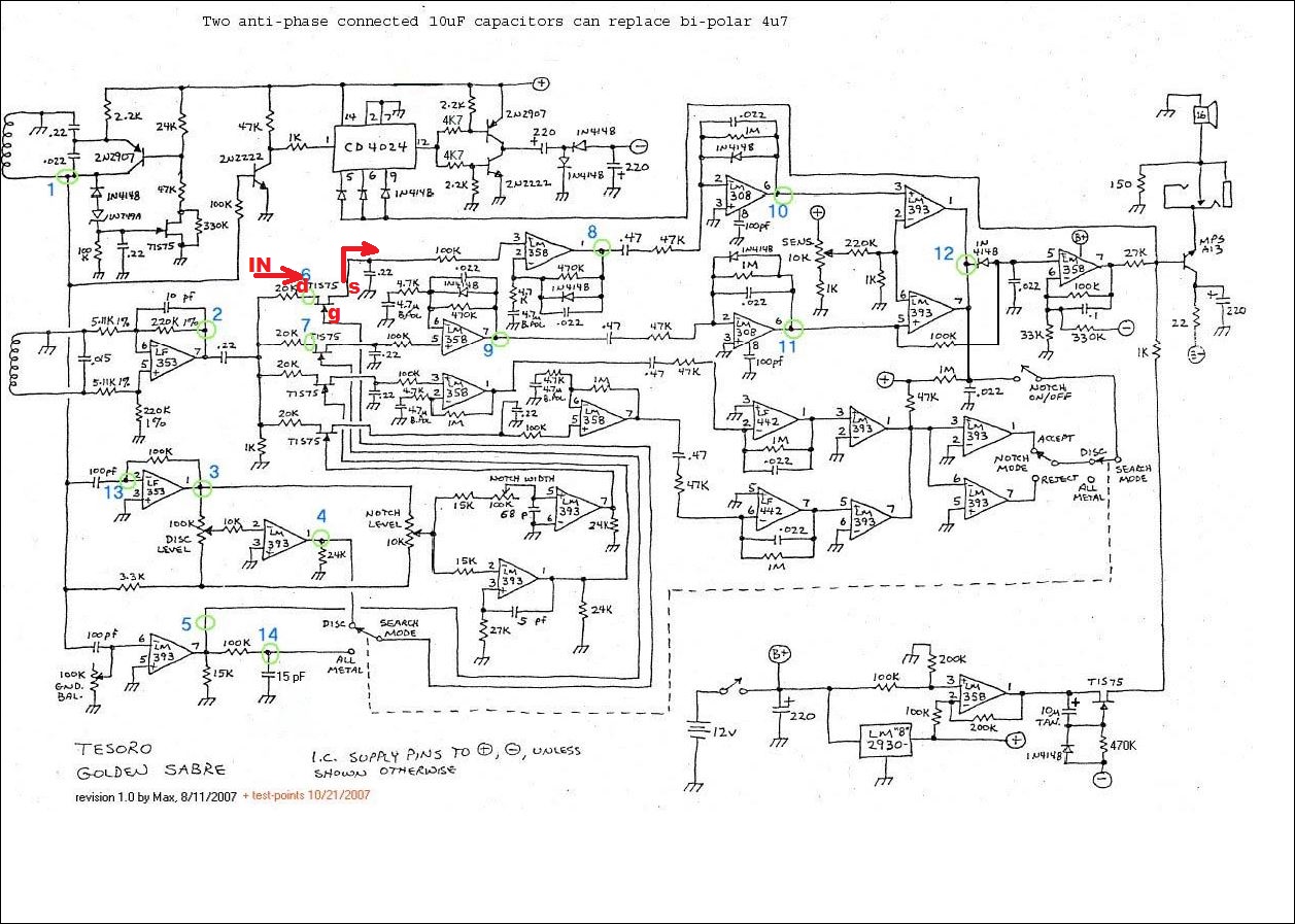

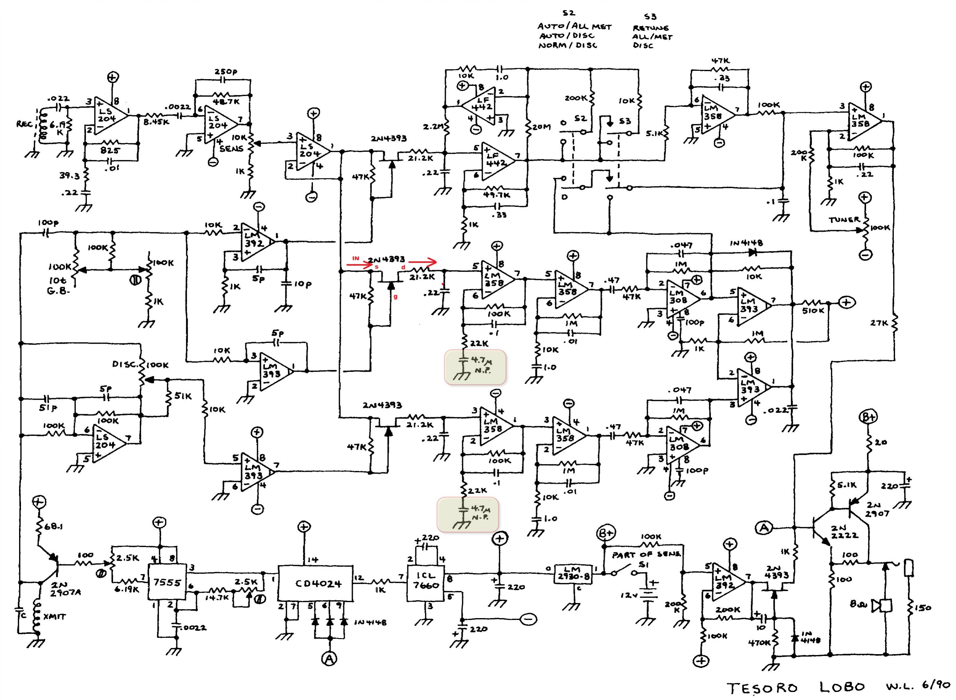

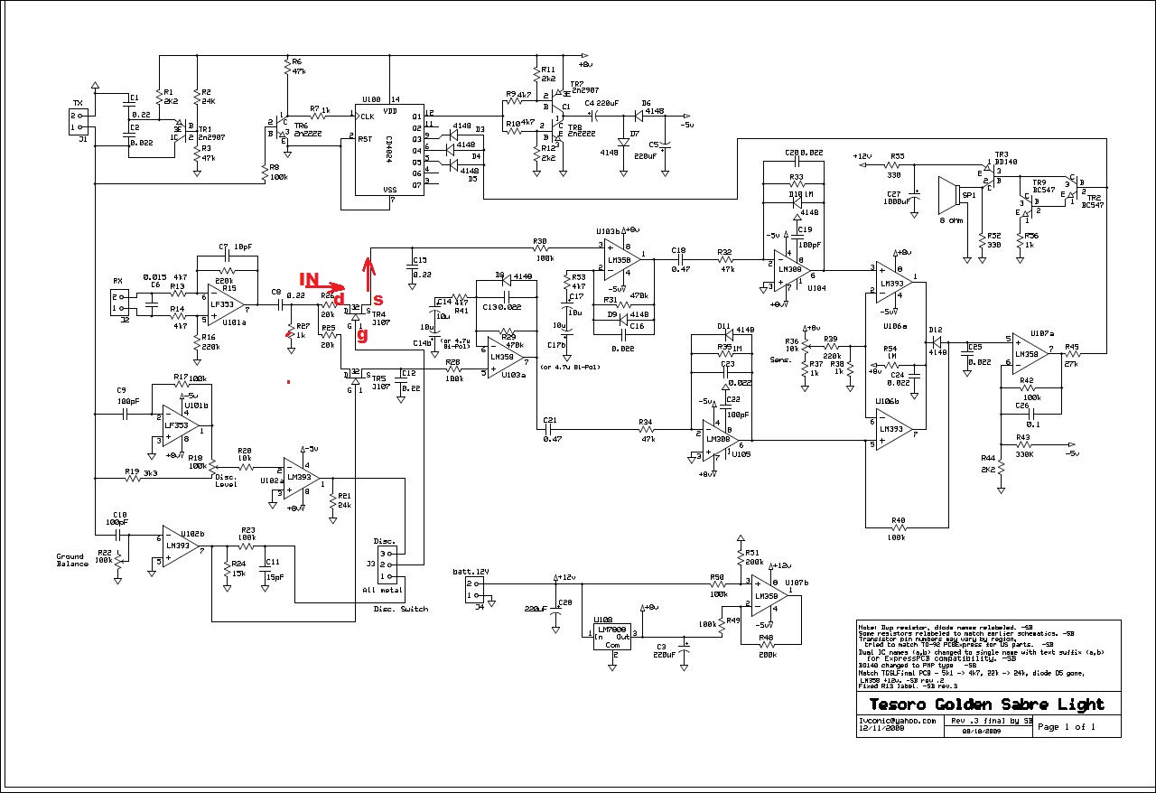

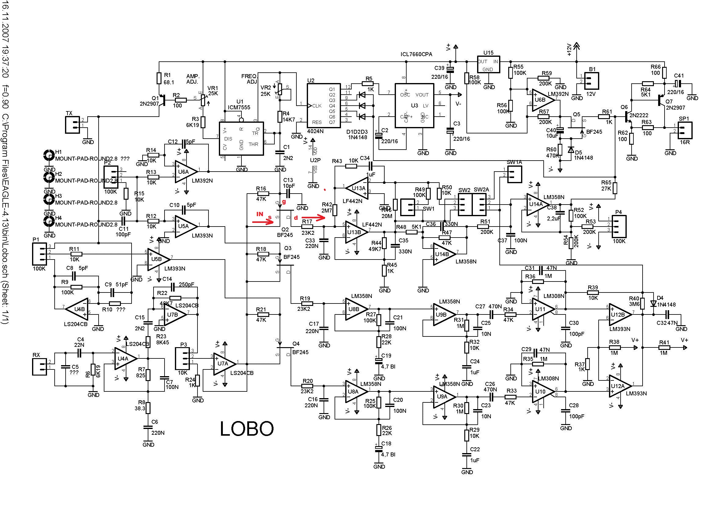

    I well understand if the reverse is who can explain,Bf 245 pinnoutClick image for larger version

    all the best
    JFETs conduct at low reverse voltage applied at gate, but stop conducting when higher reverse voltage is applied. BF245 is a completely symmetrical device, which means drain and source are interchangeable, and it helps a bit with signal switching applications. With JFETs there is a little difference between drain and source anyway.
