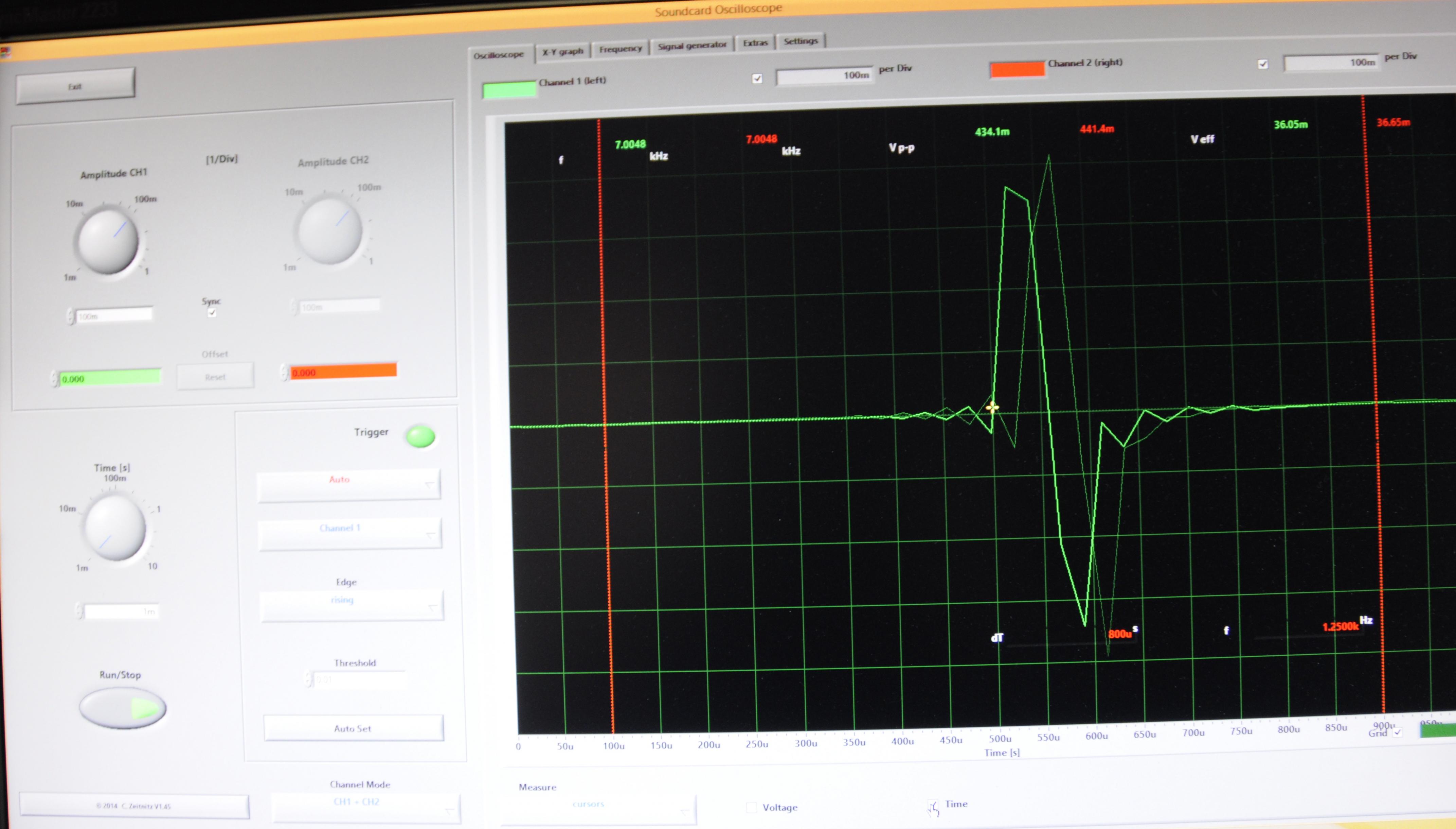

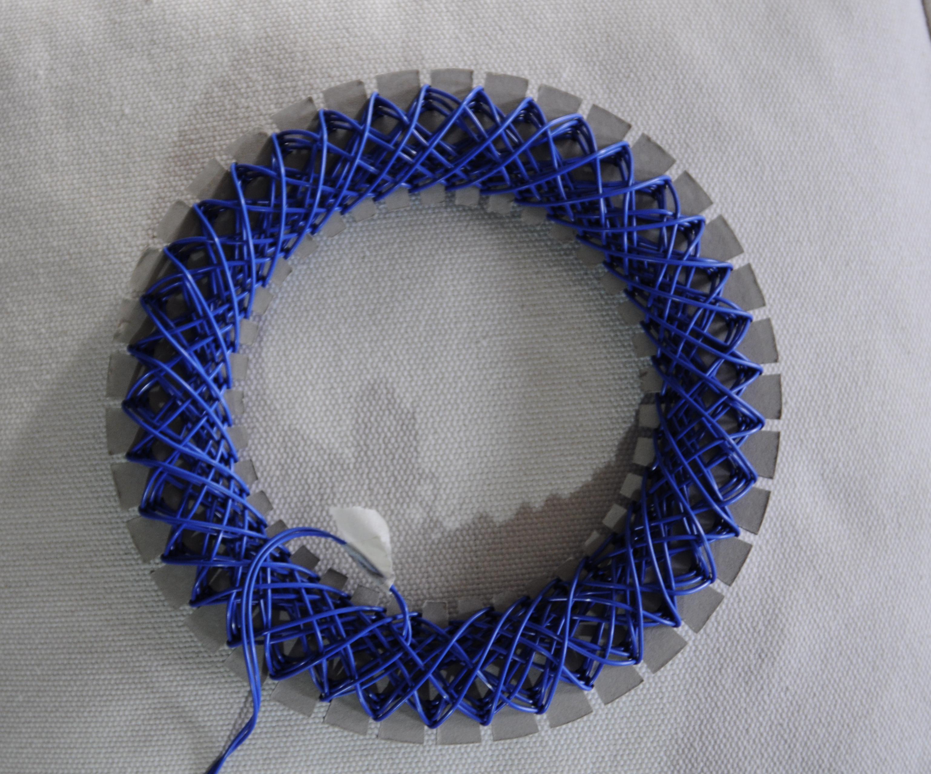

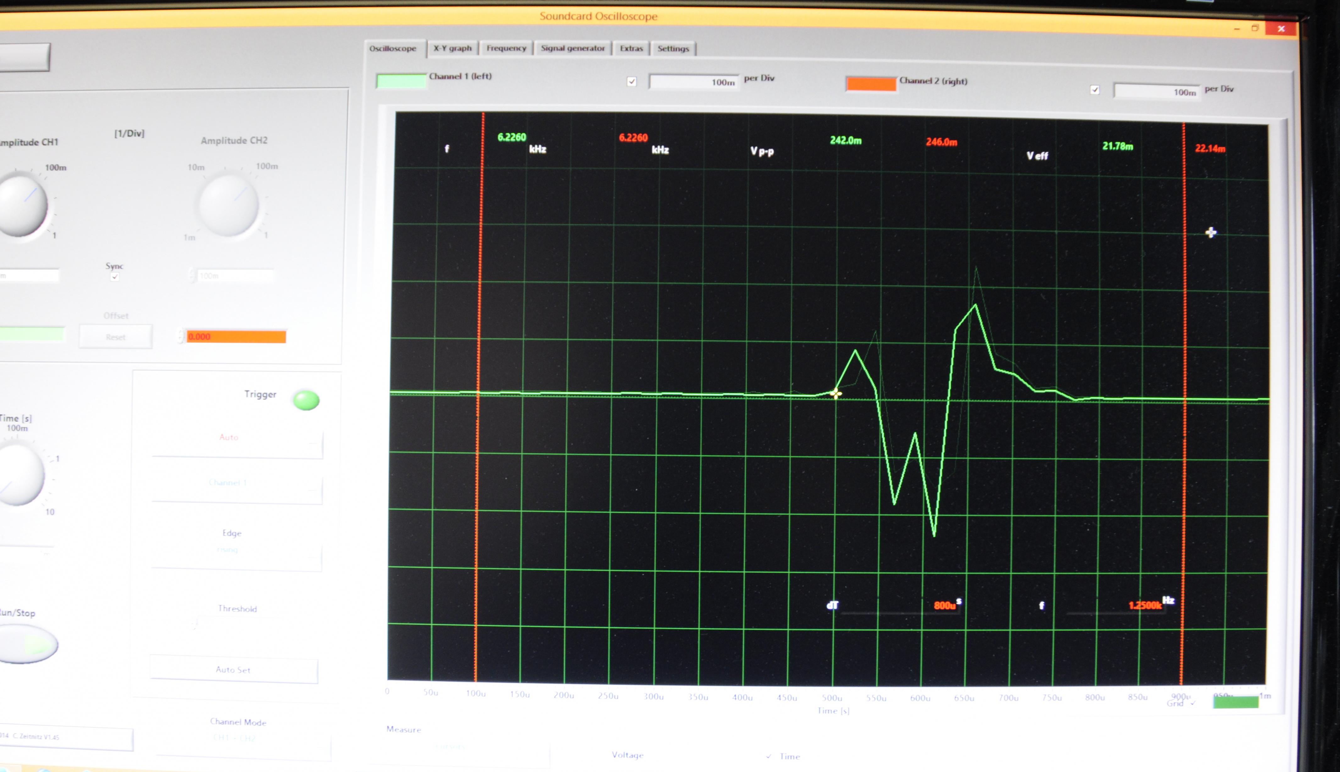

    Hi I have just built a working surf pi and basket weave coil. I can get a signal from a small piece of gold at about 5-6 cm. The only oscillosope I have access to is a pc sound card type and have attached photos of the signals. the first one from pin 3 on U1 and the second one is from pin 13 on U7. Do the signals show anything about how the detector is working or should I just presume it is about as good as I can expect it will be without better test equipment? I have adjusted the offset to 0v and the delay till I could get a signal from the small nugget I have. I have learned a lot since I joined this forum and would like to thank all the contributors for their efforts.

    pc sound card type
    They do not work well, you need a better oscilloscope to see true wave form but if you are getting a small piece of gold at about 5-6 cm you are on the right track.
      Yes I guess I was just trying to get out of buying one. Do you think one of these would be OK?
      http://www.ebay.com.au/itm/271648335...%3AMEBIDX%3AIT
        That appears to be only one channel you really need a two channel to be most usefull.
          OK Thanks. Bit more research.
            poscope mega1
              It only has a 4MHz bandwidth and a sample rate of 50Ms/s.
              You need to look for a 2-channel scope with at least 20MHz bandwidth and 200Ms/s, or preferably better.

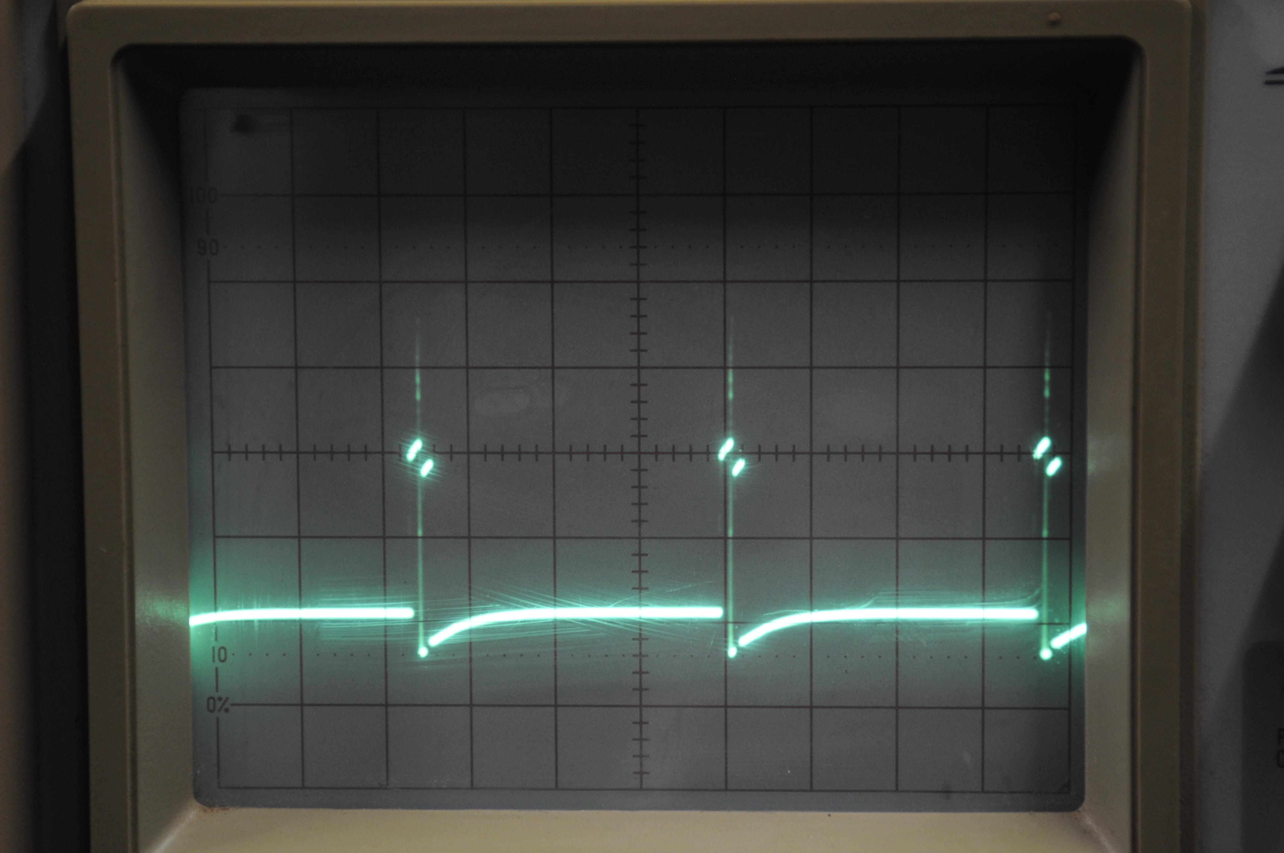

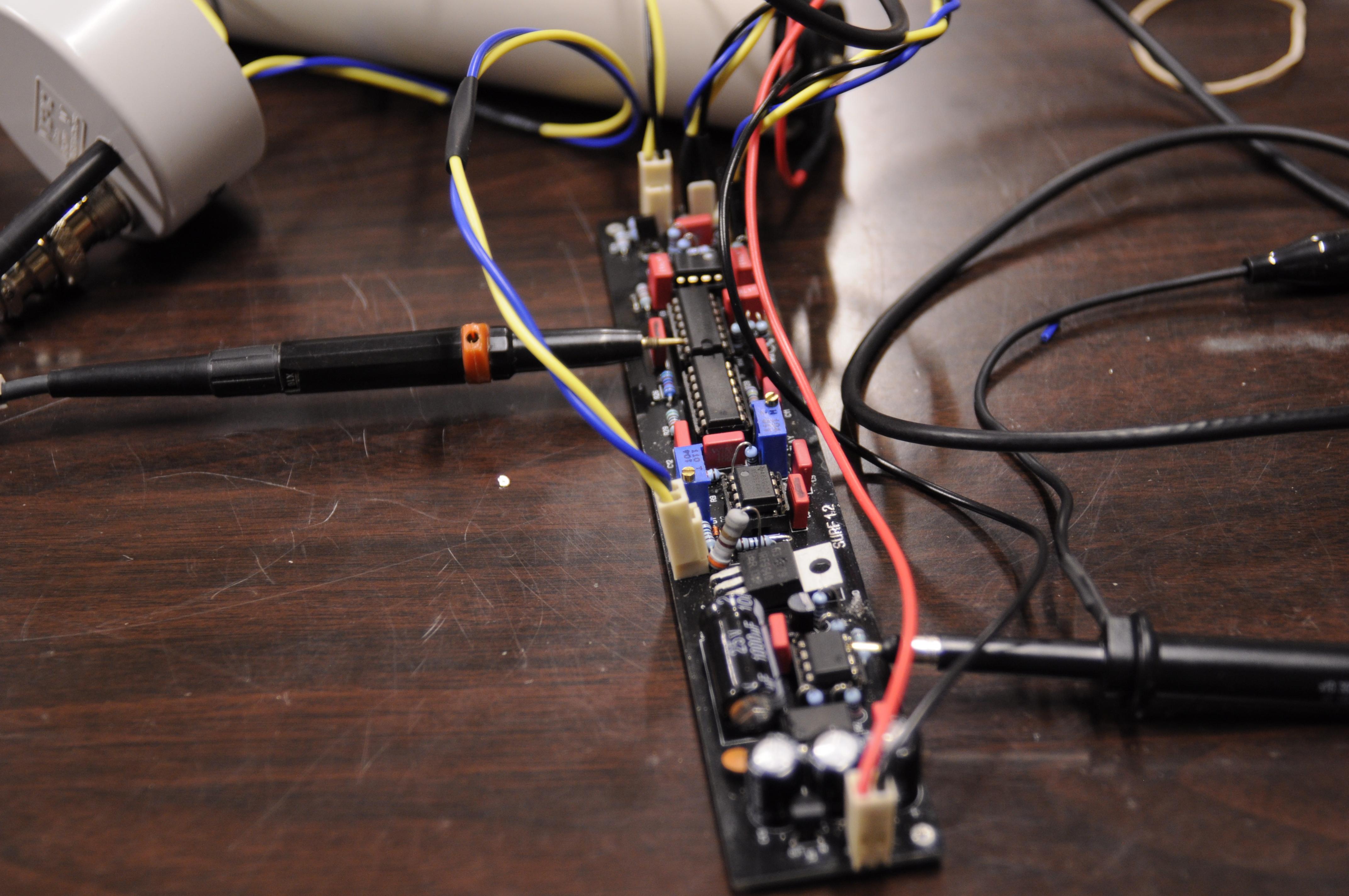

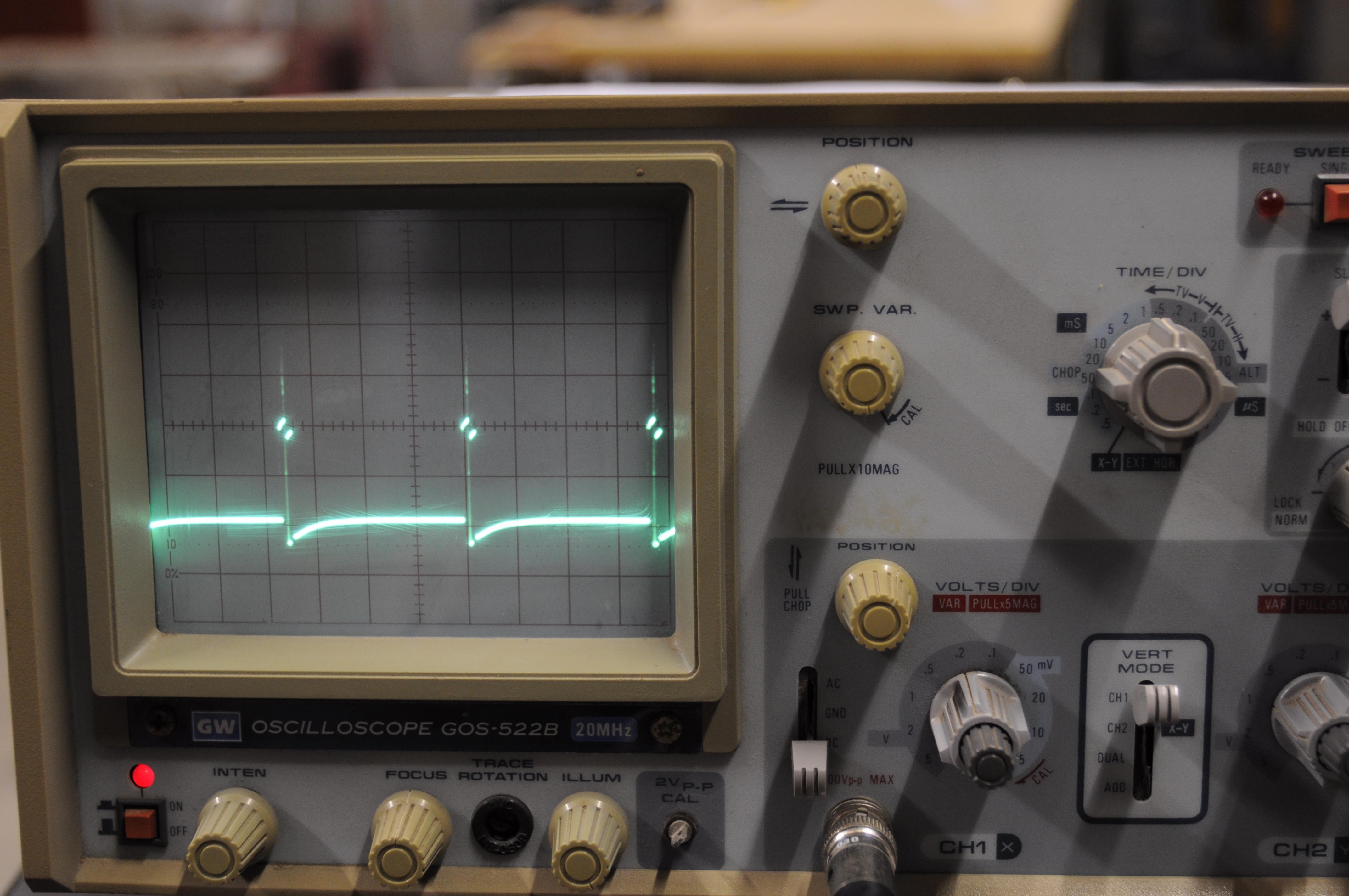

                Bit the bullet and bought an oscilloscope. Been a sharp learning curve over the last few days. Can somebody tell me if I am on the right track here. I have the trigger on pin 3 of U1 & probe on Pin 13 of U7. Does the trace look OK? Also how do I tell how fast the coil is?
                Thanks for your help.
                Cheers Peter
