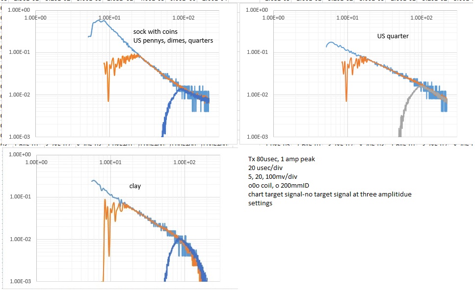

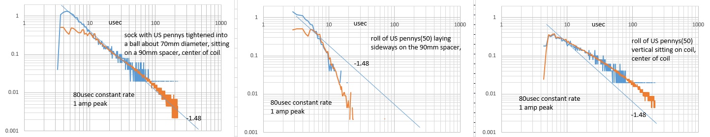

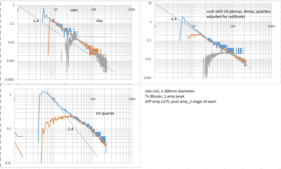

Your bag of coins represents TC's of a very wide range. Single coils, presented flat to the coil have a specific TC.
The soil under a coil has a very large surface area. The surface area accounts for the amplitude of the response. When Eric Foster made lab tests with soil, he used a very small coil, so that the soil sample was as big as the coil flux area.
