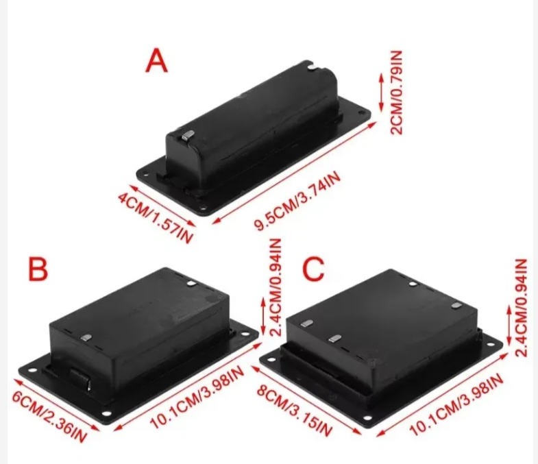

    Hello master Ivica,
    I hope you are well.
    The battery box looks quite stylish. Any chance you can share the stl?
    good luck​

      • #63
        thank you very much sir

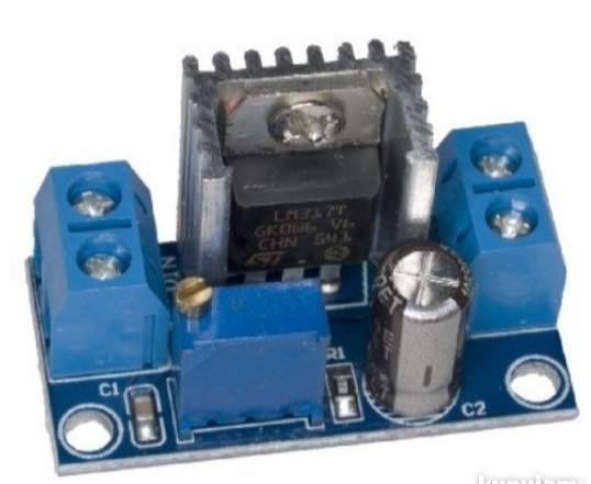

          A friend has an AKA Signum, he is quite satisfied with it, but he complained to me that the detector simply "eats" batteries.
          When I checked, depending on the operating mode; detector consumes from 150-280mA !!!
          So I added this case for 3 higher capacity 18650 batteries in series, a switch, an LED and an LM317 regulator set to exactly 9V.
          The LM317 has a heatsink, but after 20 minutes of operation the heatsink remains quite lukewarm.
          I don't have time to get serious about this detector, I haven't even tested it outside the room.
          It looks impressive in the room. Quite a nice detector and seems to me to have potential.
          Click image for larger version  Name:	lm317.jpg Views:	64 Size:	34.8 KB ID:	433531​​
          Aka Signum can have high current consumption... especially when you use the Turbo function..which increases the TX of the Detector..
          You made a good move Ivconic.. Li-Ion Batteries are ideal for such a detector..
          AKA INTRONIK is already ready to use Li-ion cells 18650...​
