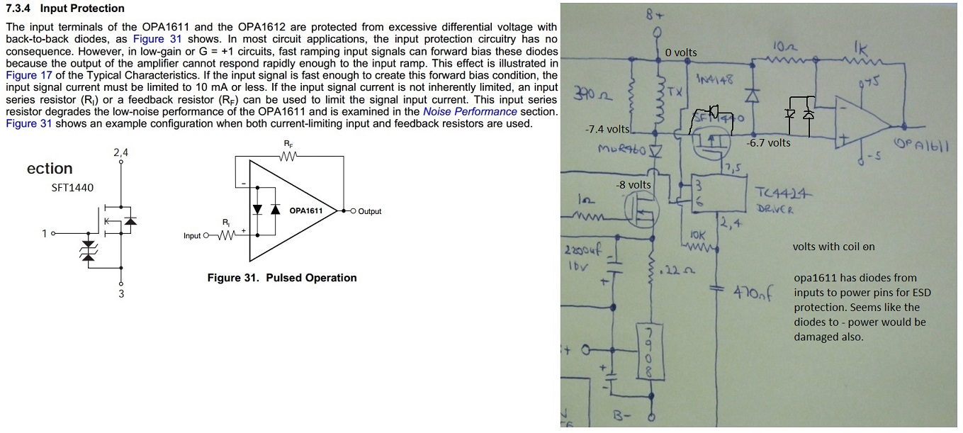

    Maybe I'm looking at it wrong, why doesn't the op amp get zapped thru the back diode across the 1440 when the coil is on?

      Maybe the 1N4148 takes the nasties away ? Also curious about the zeners (TVS?) cathode to cathode between gate and source on the datasheet.

        All I know is the 1440 is switched off during TX and I've been using this circuit for a long time without blowing up any op amps, so it's obviously reliable.

            Not saying it doesn't work. Trying to understand where my thinking is wrong. To me it looks like the diodes open and the op amp keeps working, or I'm missing something. Seems like if the diodes don't open there would be over 500ma thru the 10 ohm resistor.
              I think it works because it only conducts during the TX period. Say 100us. Mick did not
              mention the pulse frequency. But the average current would be well below 500mA depending on the duty cycle.
              The SD2000 and QED use a P channel to block this current.

                        Would it be possible for you to put a 1r or 10r resistor in series between the fet and preamp and measure the current during the tx period? I wonder if a bit better performance could be gained by using the p fet as well, stopping the diodes in the preamp conducting(well at least conducting so much current) causing a bit of heat and also causing a bit of heat in the fet.

                          I'll try a 10r resistor and see if I can measure across it.
                          When I tried a Pch, I had problems with ringing etc. so I gave up on that idea.
                          I've got two detectors built exactly the same, one in use and the other as a test unit for doing mods. This second one I've had running on the bench continuous for 6+ hours a day over multiple days and hasn't fried anything so far.

                            Did you use a low C, low Vf diode at the junction between the n & p fet to drain off the charge? This tends to be the source of the ringing at first fet turn on, also turn on timing is critical.

                                From memory it was a BAV99 or similar.
