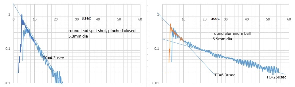

                    Charted a small lead and aluminum ball. Zapped the Tx circuit yesterday, got some oscillation that shouldn't effect the decay curve after repairing circuit. The lead ball charts exponential, the aluminum doesn't until after it's TC time(maybe).
                      Using equation 3:
                      we have:
                      Target #1 (round lead split shot pinched closed) 5.3mm diameter. for lead = 4.55 x
                      = 4.1us versus 4.3us (measured)
                      Target #2 (round aluminium ball) 5.9mm diameter. for aluminium = 3.50 x
                      = 38.8us versus 25us (measured)
                      Regarding target #2, the measured result is probably being skewed by the initial [faster] decay shown in the curve.
                      It appears that Equation 3 is not​ as suspect as I first surmised.

                          Using equation 3:
                          we have:
                          = 4.07us versus 4.3us (measured)
                          = 39.78us versus 25us (measured)

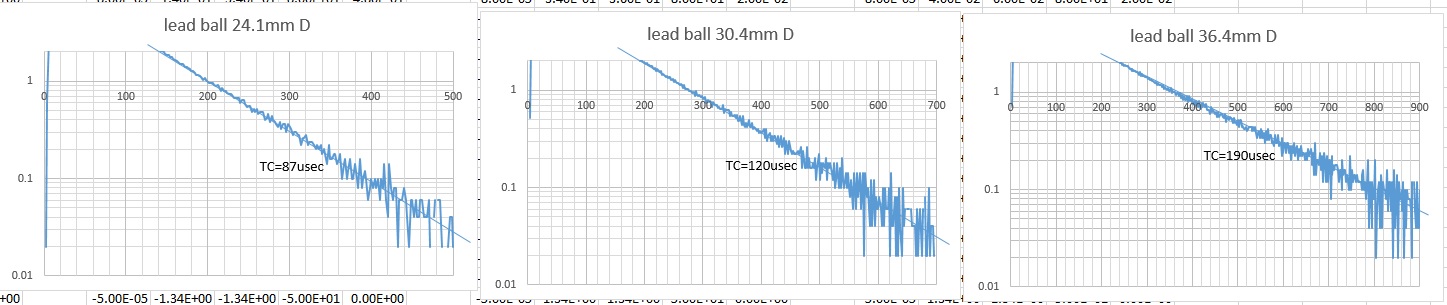

                          I'm having trouble with the simple math. Could you enter all the numbers in the formula as an example? I charted 3 more lead balls starting the decay curve much latter. Including the charts to show what I did. Won't be necessary for other time constants if they decay exponential and start time is included. Example: 30,4mm lead ball, TC=120usec starting at 200usec. Tried the 5.9mm ball again, TC= 37.3usec after 50usec, closer to what you calculated.
                            The equation is:
                            Hence, for the examples supplied:
                            and:
                            1) 24.1mm diameter: = 84.1us ... measured as 87us
                            2) 30.4mm diameter: = 133.8us ... measured as 120us
                            3) 36.4mm diameter: = 191.9us ... measured as 190us
                            Pretty damn close!
