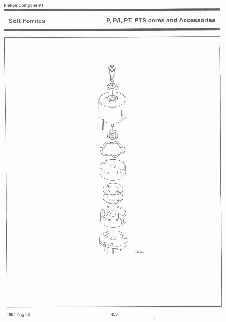

      I would like to build the deep seeking metal locator,but am having trouble in locating the coils that are used.The coils are by philips and are no longer available.Could anyone look at them and give me an alternative e.g R.S components or maplins parts numbers?
      Cheers Dean...........
        Re: PE Magnum
        Hi Dean
        I read the coil description twice and it looks to me that you can't buy the coils. You have to wind the coils by yourself. The author gave only details what kind of coil bobbin etc. he used for the coils and where you can get them. Attached is a detail drawing of the P18/11 coil accessories. Maybe this helps you to find them or similar.
        Chris
