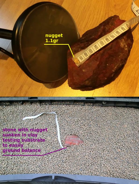

            VLF's in first line, I successfully tested this way Garrett AT Gold, Fisher Gold Bug, old Tesoro Diablo II, Tesoro Euro Sabre II (with small coil) and some other VLF's using small coils (5-7") if avalable. No tested PI was successful (honestly: no small coil was used along with PI and no sample time was set): tested different handmade PI's, Cscope CS4PI and Garrett ATX PI. Have old BH Outlaw BFO too, but it was not able to detect nugget under ironstone this way.
            PS: As I see, adding pic in usual HTML coded link is now blocked in this forum? I can only guess why?
