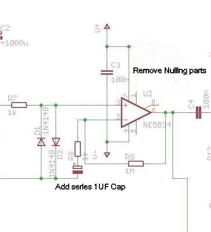

    ive tried the LT1028 in the surf pi but i cannot get the voltage from pin 6 to zero using the offset control...it will only go down to about 0.6v
      i think your right kt315....noise is something very hard to get rid off in a pulse machine cause coil untuned and very broadband.
        use a tantalum capacitor 1uf in series 1k resistor of inverting input to the ground .this way you make a high pass filter from 159hertz and down
        and get rid of the nulling circuit because this way is auto nulling.
        You will get rid a lot of noise this way

                  This does not seem to work ?
                    you mean this is not working.it is working with surf pi circuit it is tested. it is also tested years and years before with other op amp circuits, this

                      The auto null does not work, but will try again

                        Tried again , Nope it dont work as soon as you put a cap in series with the 1K the preamp stops working.

                            What I did after reading the post above was I removed the nulling parts from the opamp from a surf pi
                            and added a 1uF cap in series with the 1K that goes from the inverting input thats pin 2 to ground
                            but when you do the preamp stops working, am i misunderstanding the above post ?
                              It would be handy if this auto nulling idea worked
                              My error. I thought maybe the input went to the negative input of the op amp. Looking at your schematic the amplifier out offset should be bias current times 1 million.
                              I Just tried your schematic with spice, not working maybe some thing I'm doing wrong. I'll look at it some more. Worked with spice with coil going to -input

                                you are not misunderstand I just forget to mention that this circuit it is used to phono preamps so the input signals are in the order of 20 millivolt maximum .In the surf pi I used a rail to rail input op amp with very little offset the opa350 and worked with 1000 amplification.
                                After this I used convetional circuit with 2000 amplification and now I am receiving the whisper of a 2 euro coin in vertical position 27 cm in the
                                earth.Anyway with opa350 and 2000 amplification I have only 70 millivolt offset without nulling circuit.
                                ps it is the best op amp for this application it has very fast recovery time from overload .
