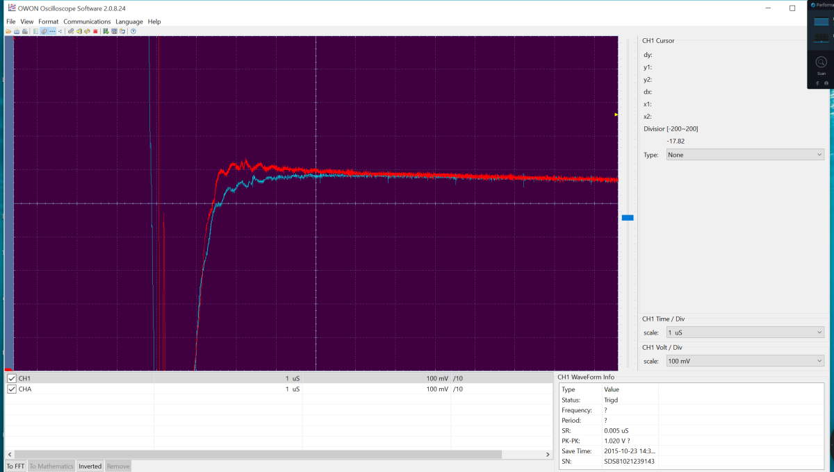

                        Attached a scope shot of a foil target at 1us, Preamp is AD8055Click image for larger version
Name:	Foil at 1us.png
                          Sorry, the picture was a bit large.
                          Blue trace =No target
                          Red trace = foil target
                          Setting: 1us/div
