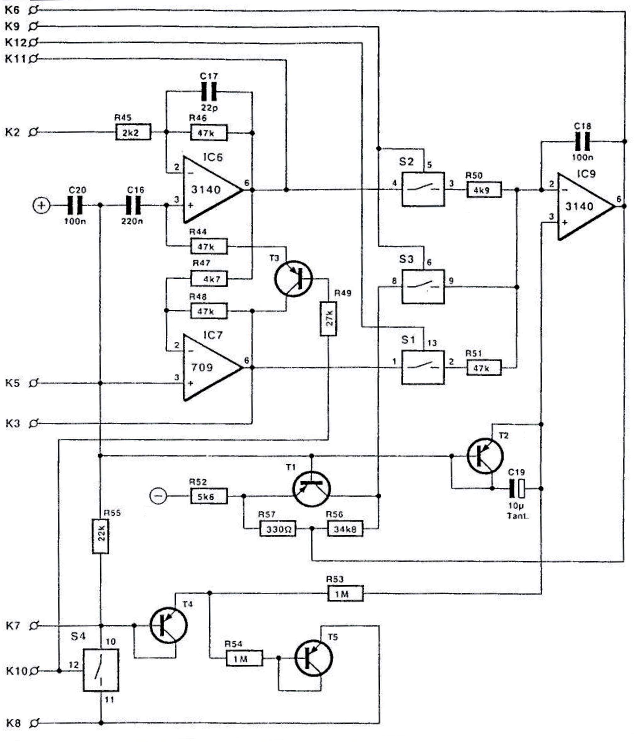

    Hi all iam using dbp 2010 pulse induction metal detector if any one can explain for me the sampling stage and the upper pcb the 3op amps and cd4066

      Hi man
      I have cloned the dbp 2010 about 24 years trademark of it sniffer xr71 I do like so much thats why iam looking for the timing explanation
        Originally posted by JAFAL View Post
        Hi man
        Ok.
        To be more precise; it is actually a sort of "filter" configured as sample and hold, serves here for ground canceling.
        Portion of signal is capacitively evaluated and than stored, stored value is then compared with the received signal.
        I don't see what more there can be improved, without changing major concept.
        It's pretty straightforward circuit, easy to understand.
        Here is the schematic;

              Thanks for your response
              I do like to know what the transistors functining and whats the point that t4 and t5 conected as diodes
                        ivconic
                        Transistors connected in that way are often used to substitute high speed low leakage diodes.
                        I guess author hadn't proper diodes available at the time and therefore used transistors in such way.

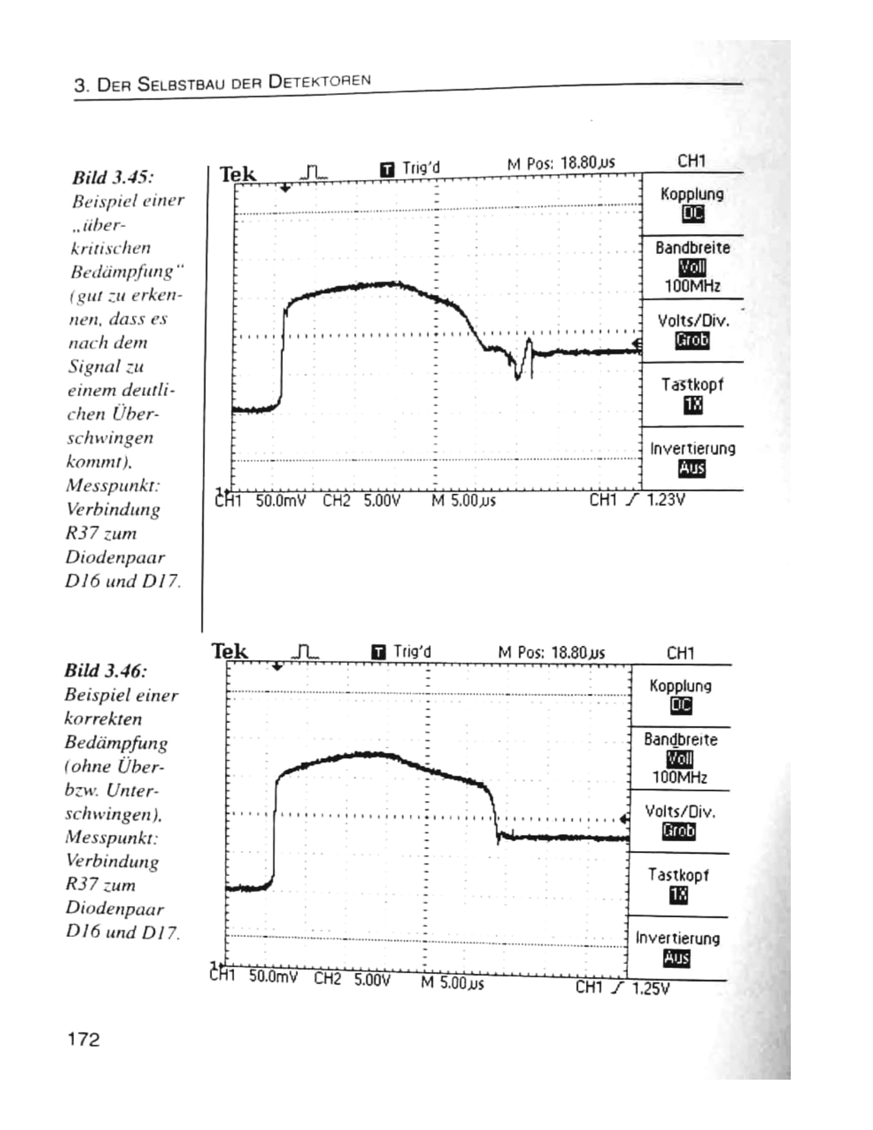

Name:	Rolf Wilhelm - Das Kompedium der Metalldetektoren-172.jpg
                            Hi ivconic
                            If you please translate this page to to me and what the signal Is ?
                            Is it dumping signal and if its whats the relationship between it and r37
                            On the schematic r37 is the sound output
                              Hi ivconic
                              Yes true the transistors acts as high switching diode and I think with respectable current
