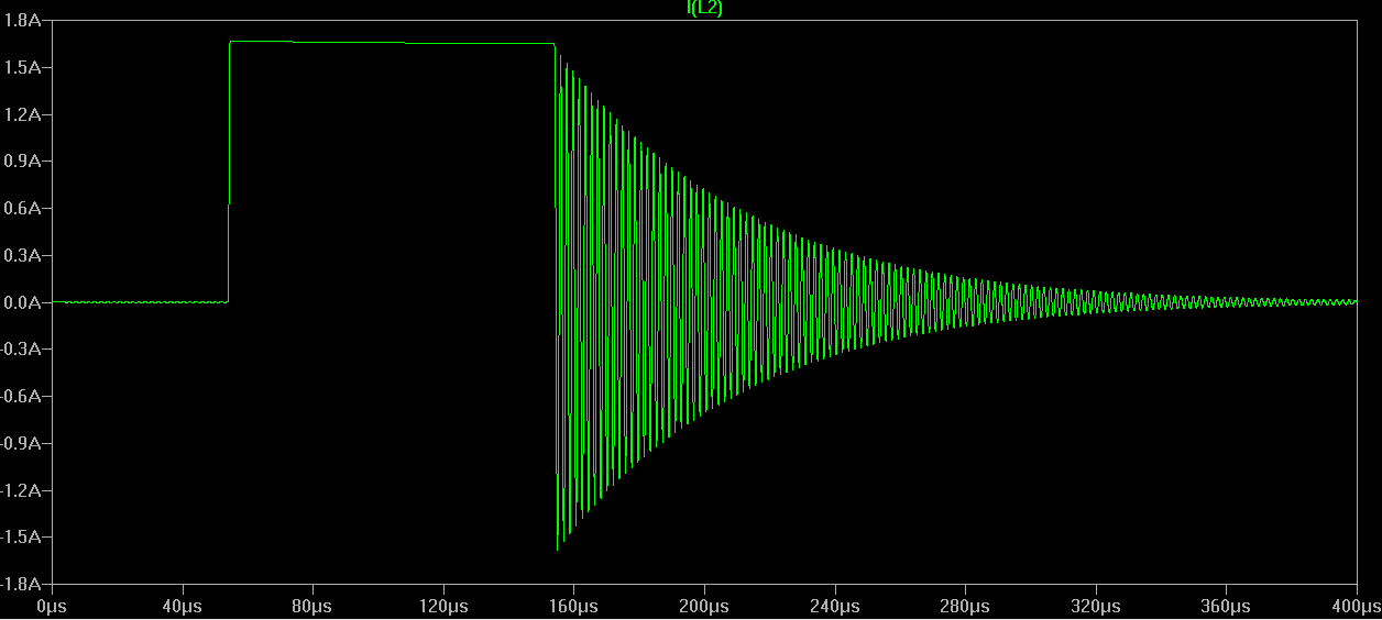

              A pulse like this:
                as far that i understand i thought ferrous disc could only be done using 2D coils...i know detectors like the chance and others using microprocessors can in some way discriminate out ferrous...and from what i can see from some of the eric foster designs he uses extra samples to get discrimination in some way...not sure if any can discriminate to full depth ???
                  is that waveform back emf curve without damping resistor ???
                    The rising edge is constant current, the falling edge is underdamped. After the rising edge you measure target rsponse (using IB Rx coil), during oscillation you measure frequency for discrimination.
