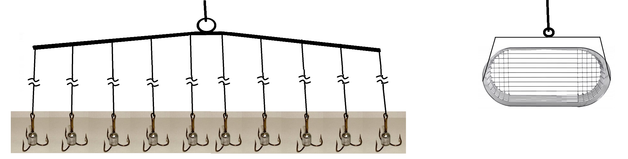

              I would suggest a drag line, kind of like this Click image for larger version
                would suggest if you get out a drone above water to attach at its top some piece of a styrofoam. and Lo! Voila! your
                drone will swim like a popup bobber!
