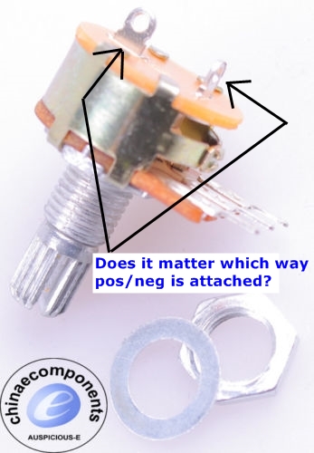

    I know this should be elementary but does it matter which way the pos/neg is attached to an on/off type potentiomenter? I have not used them prior, only spst
    switches in my builds and other stuff but I want to add one to a current build I am working on. I only have one so don't want to screw it up, I'd like to know for sure since I am not finding any info on it and before connecting it up.
    Thanks in advance..
    pic attached
Name:	plus neg hookup.jpg

        Hi Geo
        The switch is a SPST, just ON or OFF and has no polarity. It is also isolated from the Pot.
        Have a good day,
        Chet

          Thanks Chet, that is what I assumed, same principle as a standard toggle. I just wasn't sure if it was connected inside since I have never used one for building stuff.
          I appreciate the replies guys
