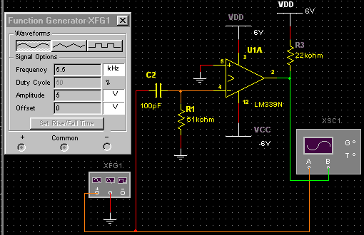

    dear Marcello, if you can say me the Tesoro transmitter (what Tesoro's one you did mean off?) frequency value, so I will emulate the circuit in MULTISIM-2000 and then give you the accurate diagrams.

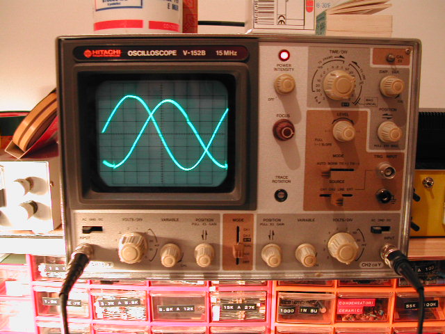

      Thanks Kt315.
      I have built the tesoro eldorado and have bought the search head original tesoro (concentric brown with central hole) and I get a bewilderment tx-rx as in photo!
      In the video of the site Tesoro is seen a bewilderment tx-rx of 180°..... therefore the doubt rises me that the search head in my possession correctly is not function.
      Thanks for the help

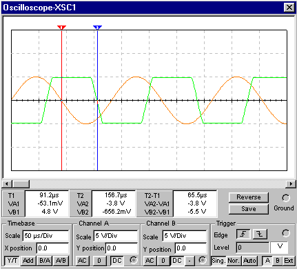

          if frequency as I see on the photo is 5,5 kHz, so a comparator gives 65,5 ms of delay.
          certainly in case if LM339 is similar to LM393 (with signal inversion?) because MULTISIM has not LM393 data base description.
          all the best
