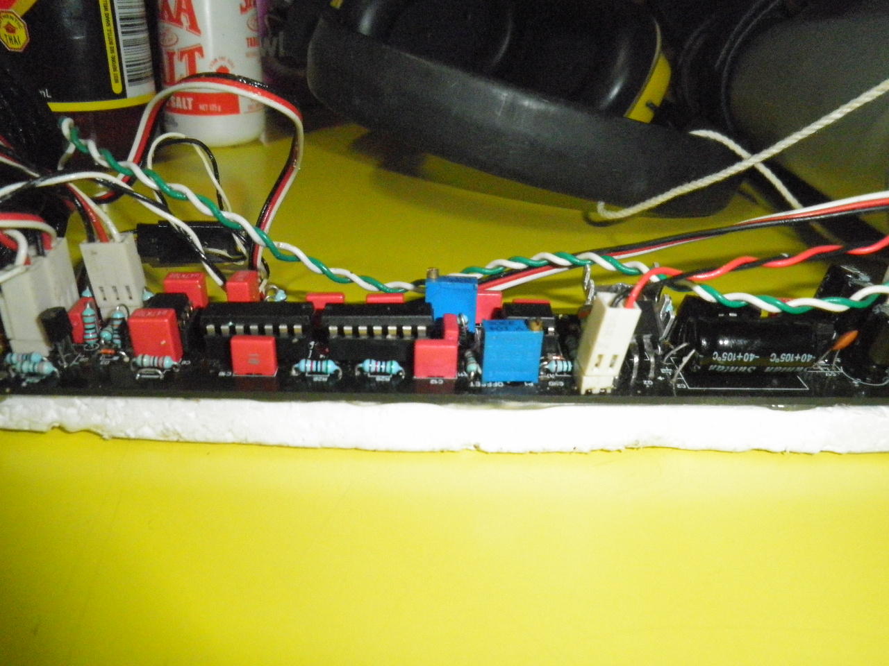

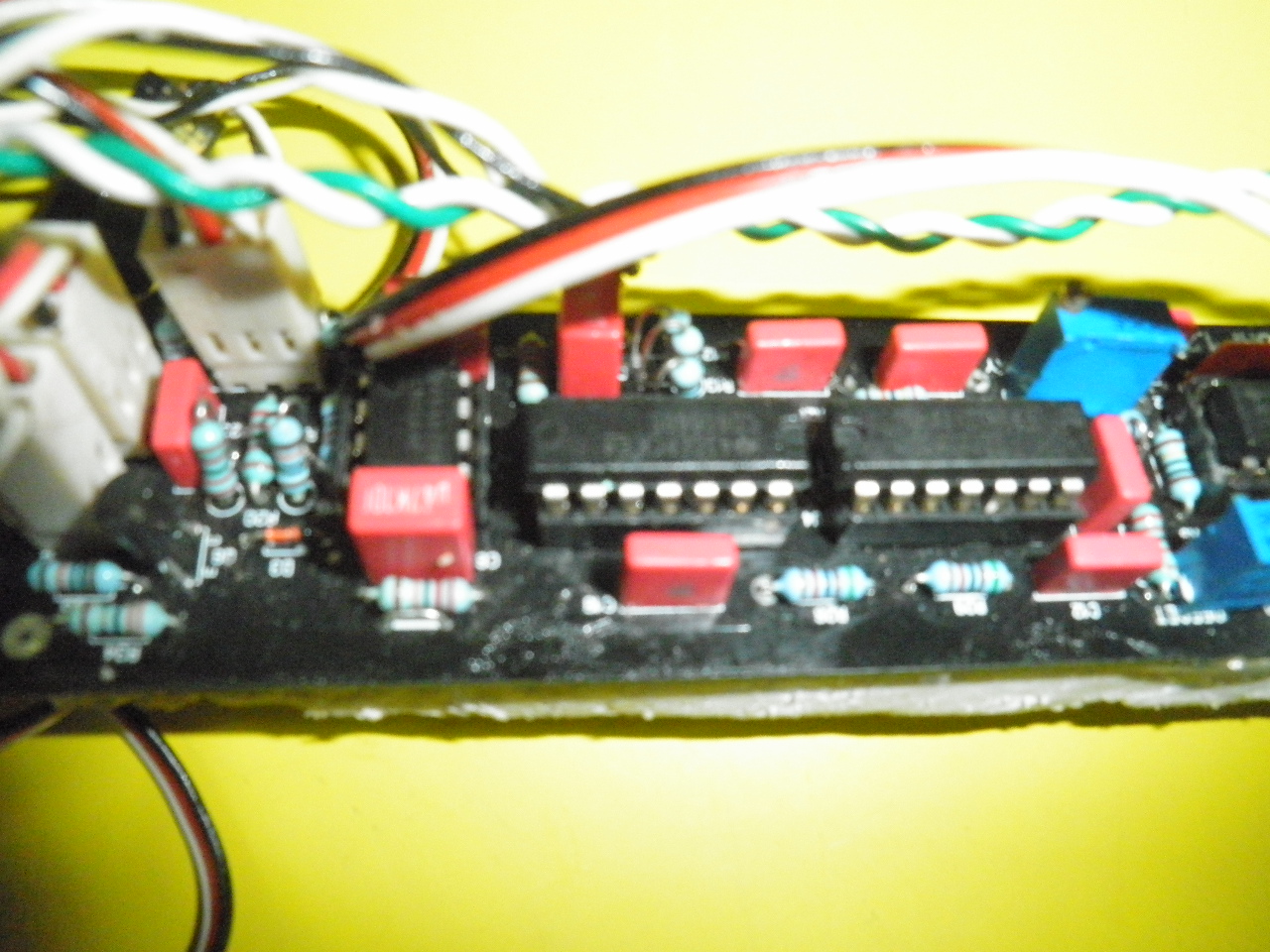

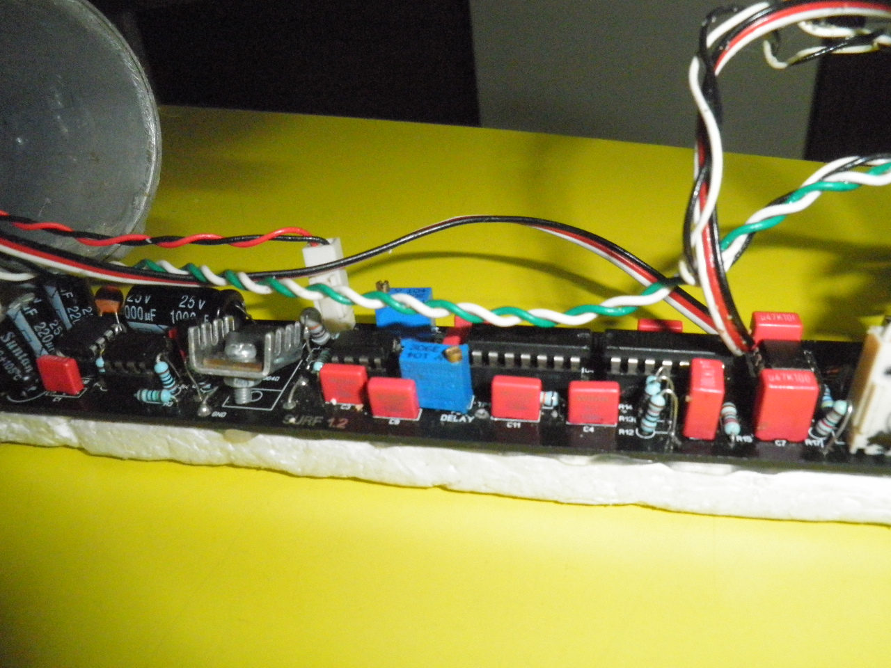

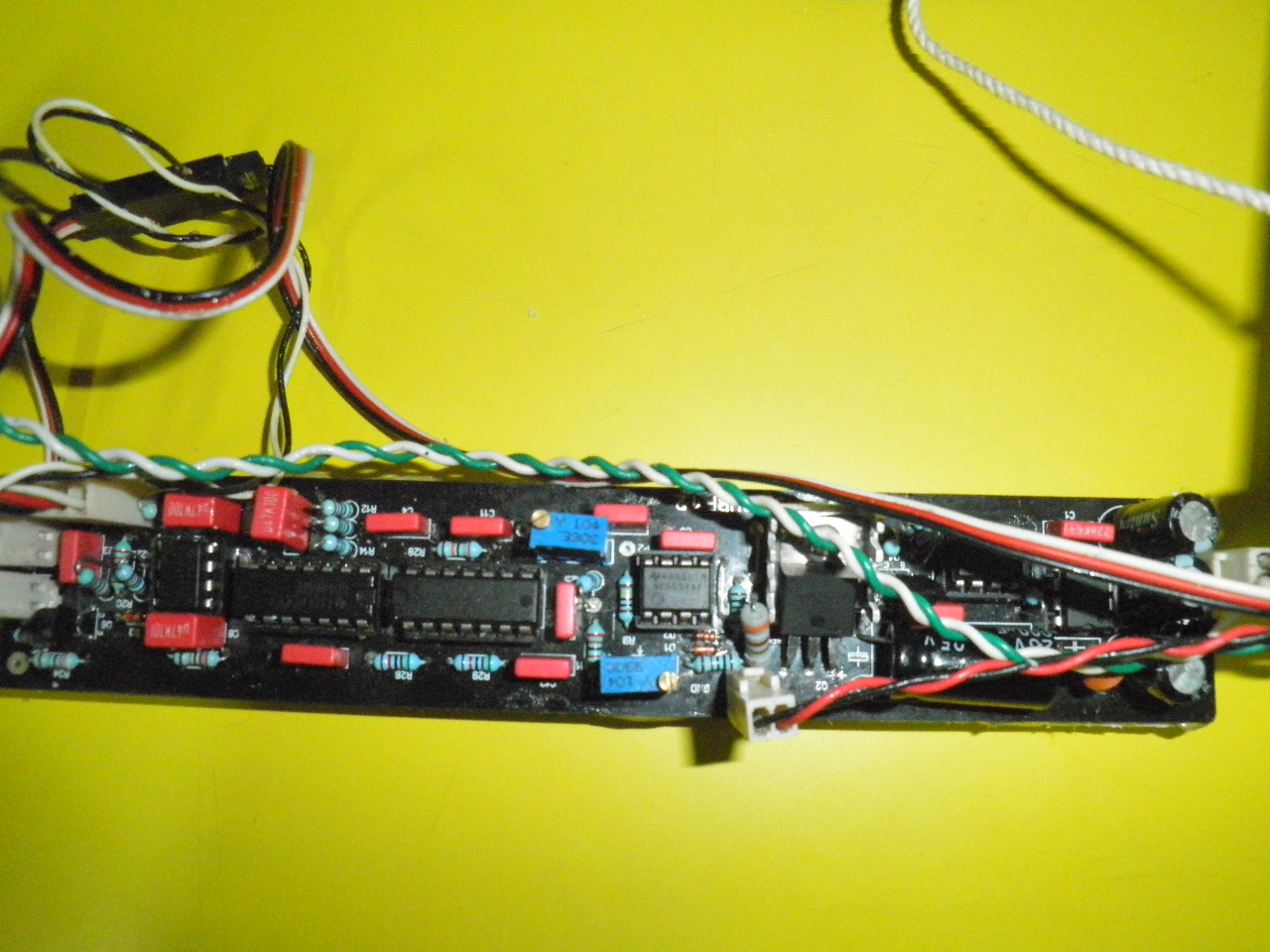

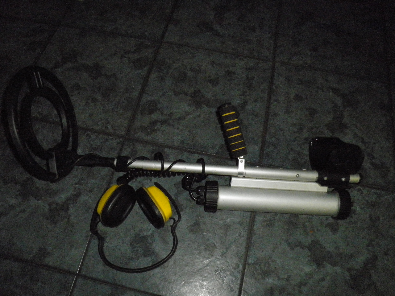

                      i spent a lot of time downloading peoples circuit board pics that worked from many web sites before i built mine i bet you have put something in the wrong place mine fired up first time
                      check my pics out in my profile has build pics this is fully under water unit and ear phones .pm me if you need any help guys
