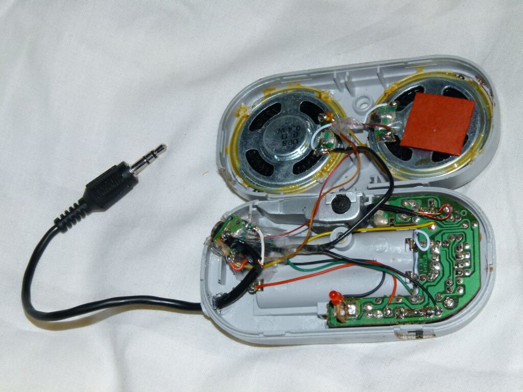

    After many hours of tinkering today I was successful
    to get the 2in1 high-quality and loud audio-mix to work.
    Without amp and just joining the audio-cables together,
    having a good time with loud music is not possible.
    The MD signals would get lost.
    Not so with an amplifier and some special circuit!
    Now it's Rock'n Roll! More infos soon!

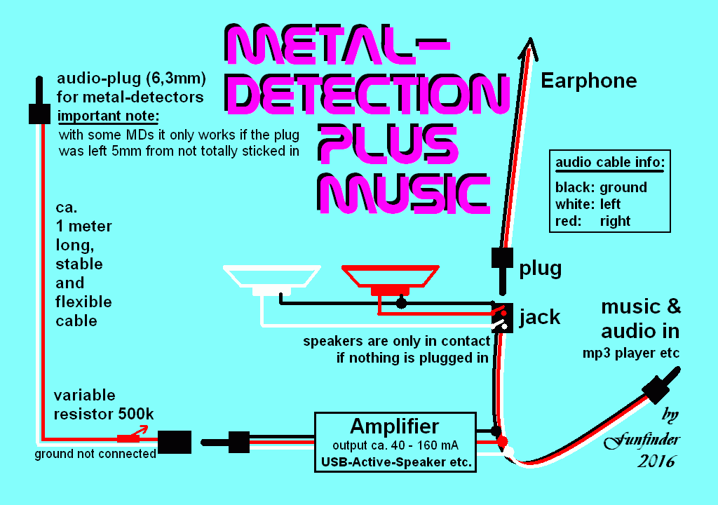

    Here's the diagram! Enjoy!
Name:	audio 2in1 -  MD plus music diagram.gif

    Because: the ground from the MDs audio has to be cut-off,
    the audio from the Garrett Euro-Ace is already very loud if
    the 500k resistor is set to 500k and while using it with the
    Blisstool, the Makro Racer and the DeepHunter, the plug
    has to kept 5mm from put completly in (in this position
    the MD has still audio-output but also the cable has it!)
    By the way I have tested it the usually working way and it does not work!
    - connecting all 3 lines as it normally should be
    - using a resistor at the ground-connection to reduce volume as it normally should be
    - pluging the 6,3mm completly into the jack - again: as it normally should be...
    The connection cable should be around 1 meter in lenght.
    For the Garrett Ace models even 1,20m (4 ft.) would be good,
    because the MDs audio-plug is pretty far away from the body.

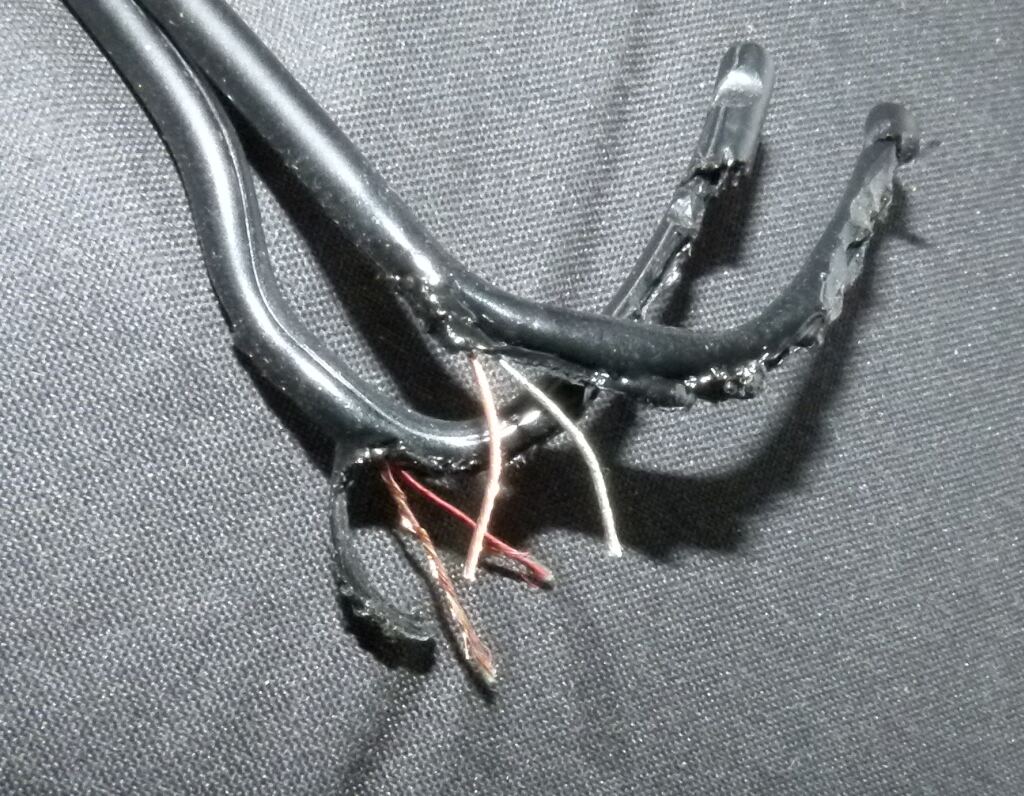

    It should be a thick but very flexible gum-cable with "unbreakable"
    helix-wire inside. Check out the makro-view below. I did use a lighter
    to melt the gum away (this way the wire can get pulled out very easy)
    and afterwards to burn away the isolation-coating for soldering.
    For protection bend over ca. 2cm of the soldering-cable-region
    for 180° and fix it to secure the spot where those very thin
    wires are soldered together with some stronger cable.
