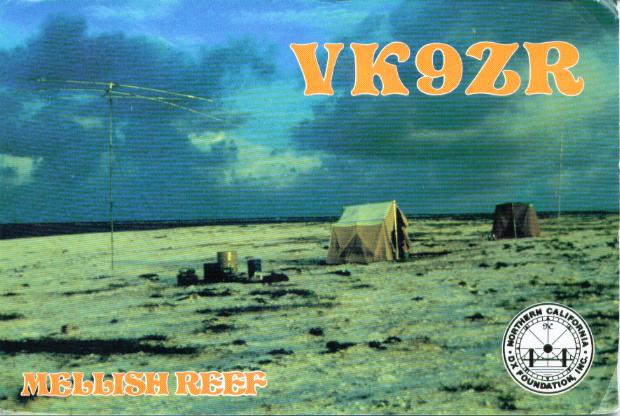

        This was our deserted island just sand.
