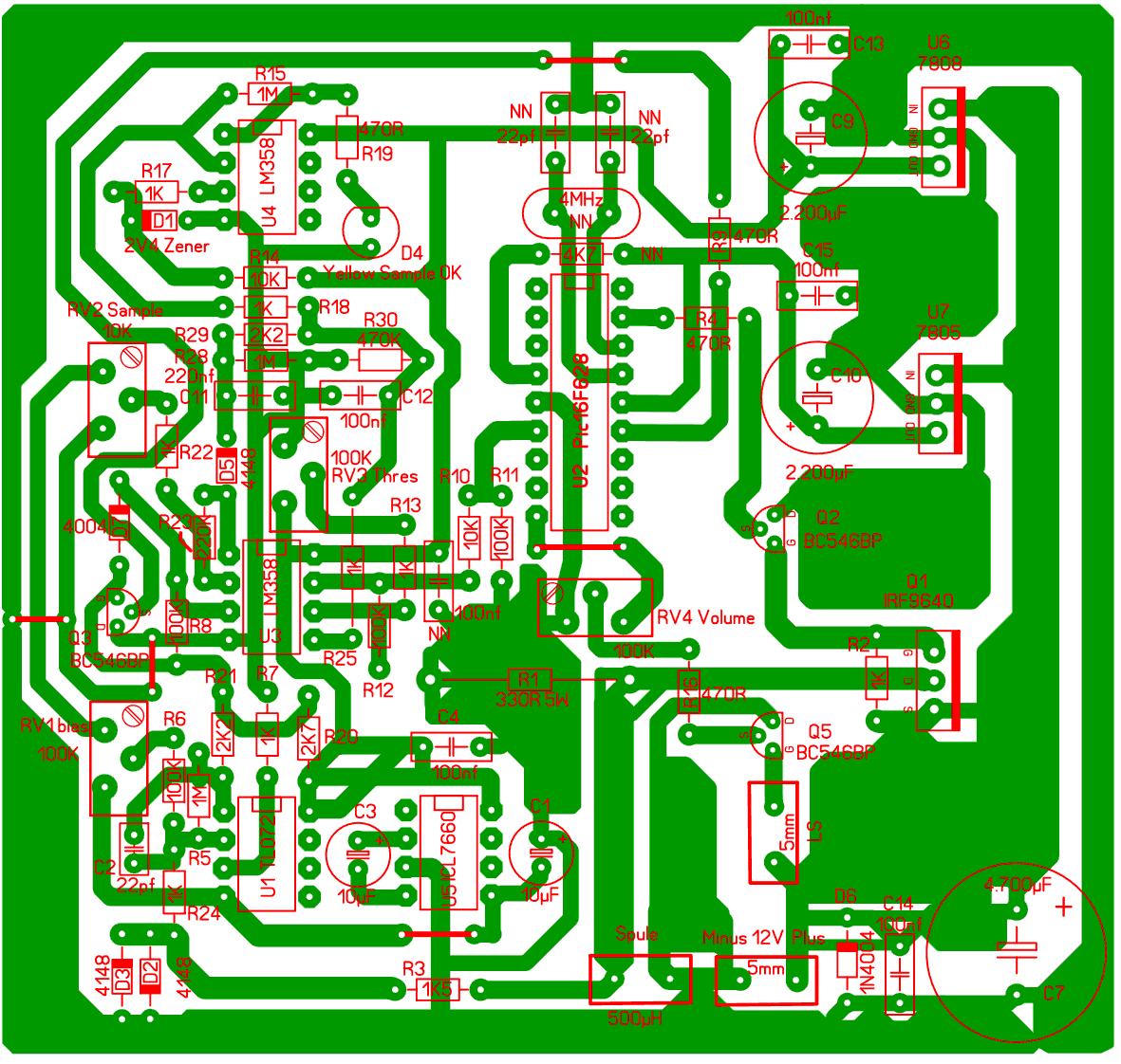

    i am on the way to re-build the NES 500 Pi Detector.
    As i know i was another Project from Baron66. (BRN Pi Digital and other Projects)
    i hope i can get some help here to improove the pcb and shematic.
    For chronology, I think the version you start with should be included as well, bernte_one ? Please post the pcb and schematic you aim to improve.
      yes, i do it asaiaha

          i have re-worked layout with sprint layout, part Placement is the same
          but better holes, better copper tracks, exact part number from schematic....
          can Export gerber, pdf , bw Image for all free to use like always
          hope we can do it together

                  Hi bernte_one good work on new layout, Ive been trying to work out the function of Q3
                  it appears to be some type of switch just not sure what it does ?
                    S of Q3 go to timer / oszi from Pic Controller
                    D goes to GND of U3 and U4 lm358 ? (maybe Timing of 1st an 2nd sample works together with U4)
