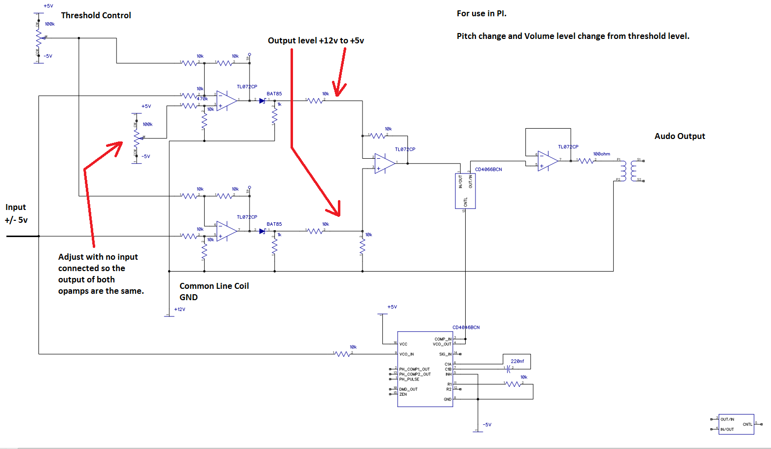

Hello Jose,
Remember the updated example (4046 vco) Mickstv offered here: http://www.geotech1.com/forums/showt...839#post210839
One idea is to maybe use your Modo Alto switch mod from your GS4 clone and have it in front of Micks audio. Just a thought. Perhaps there is a simpler way? Certainly there are times when the High/Low select can be very useful thing to have.
