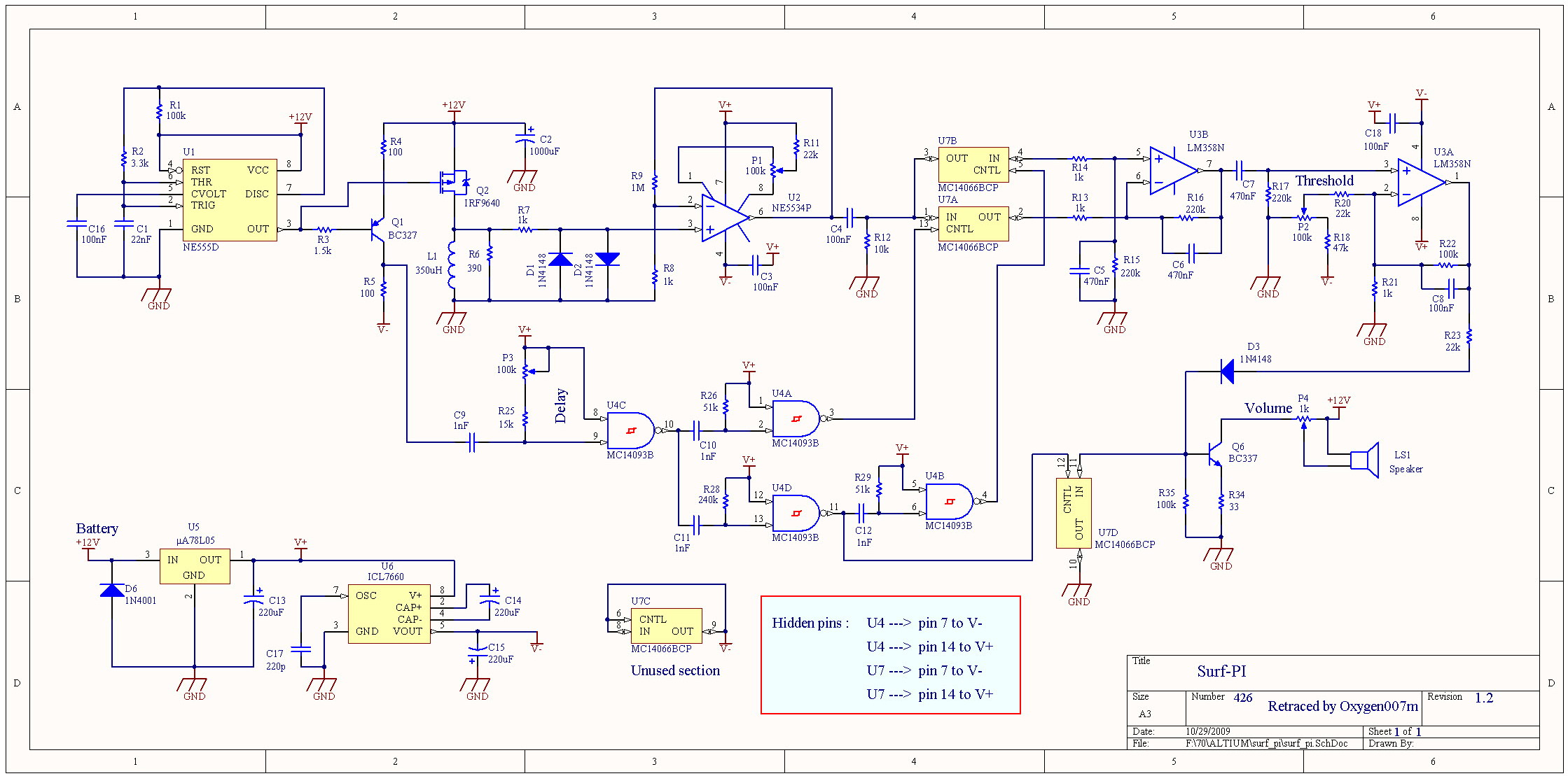

I drew this schematic it looks similar to other Surf schematics. I haven't verified all parts yet...
[ATTACH]34970[/ATTACH]
Looking forward to see how your build goes, please keep us posted as I would like to try and get my surf pro working.
Darin

Hello cddz. this is a scheme that I used. This works guaranteed. Power problems there. I use scheme as Hamerhed because 7660 does not provide guaranteed 5 volts at this circuit from attach scheme . 7660 must be powered with 78L09 to have a stable 5 volts and eliminate problems with the maximum power of 7660. I useUniversal Single Sided Breadboard 120x60 mm for my project.Attached Files

This is the schematic I got from the same guy cddz got his from. Maybe someone can tell me if this can be made a good detector or not.Attached Files
Originally posted by Darin View PostThis is the schematic I got from the same guy cddz got his from. Maybe someone can tell me if this can be made a good detector or not.
That schematic does not match the board that was sent to me. I think the guy just grabbed a copy from the forum somewhere. I ordered a MPP from Silverdog's site last night. Seems to be much better support on that kit.
according his text in ebay listing he gives a link there on Surf PI schematic that shared by Carl M. in post #1.
it is Whites original schematic
http://www.geotech1.com/forums/showt...55-Surf-PI-Pro
IMO this schematic may have underwater rocks.
