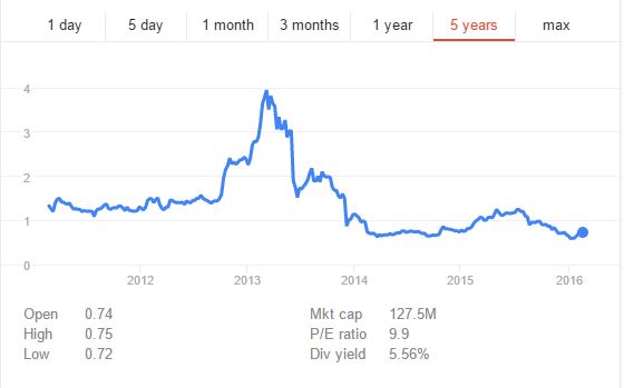

      • ... back on topic ... I have obtained the exclusive TC waveform of the target that this patent was designed for ...
        It has a decay period of about 5 years and peak target response was about 3 years ago.
          Very amusing.
          Presumably that's the share price chart for Codan Limited.
          Apparently (for 2016) Minelab revenue increased 70% over the first half with release of the GPZ 7000® gold detector and the GO-FIND® metal detector.
