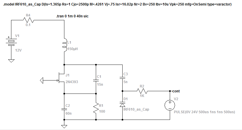

    I've been trying to design a voltage-controlled LC oscilator within the following specs:
    Inductance < 150uH
    Coil current > 100mA.
    Frequency > 100KHz and < 200KHz
    This is the best I could come up with (varicap-tunable Colpitts):
    As varicap (varactor) I've configured an IRF610 MOSFET with gate connected to source. Its Coss capacitance varies from 2500pF to 750pF as VDs varies from 0 to 12V.
    The frequency varies between 112KHz and 116KHz when the control voltage changes from 0V to 12V.
    Ideas to improve this? You can use the sim file attached for LTSpice.

          I have considered that, however, sensitivity to inductance changes is the highest with sine oscillators. So is efficiency, a Colpitts with 100mA in the coil consumes 3mA, a relaxation oscillator would consume > 100mA.

          I very much appreciate your extensive reply. A lot of food for thought.
          My reference for this design is the Falcon M20. It's a frequency-shift detector at 100KHz with a ferrite search head about 1'' (25.4mm) diameter. I want to place two such heads side-by side.
